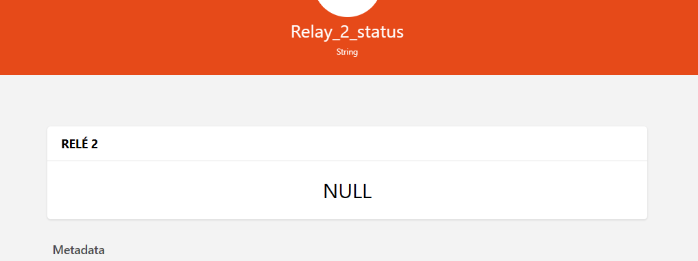

Problem is only with one string which is NULL
for this I must find other way how to handle
rrd4j doesn’t support Strings, but MapDB supports all Item types.
