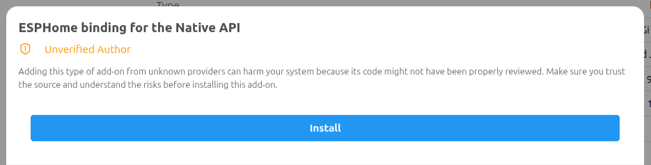

Note, when installing an add-on from the marketplace, you’ll get a warning like the following:
The key things to watch for is the “Unverified Author” part.

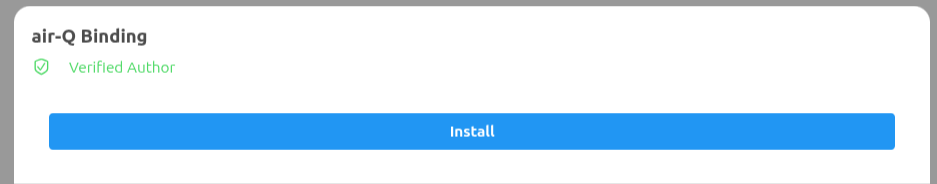

When installing an “official” add-on you won’t see such an error.
