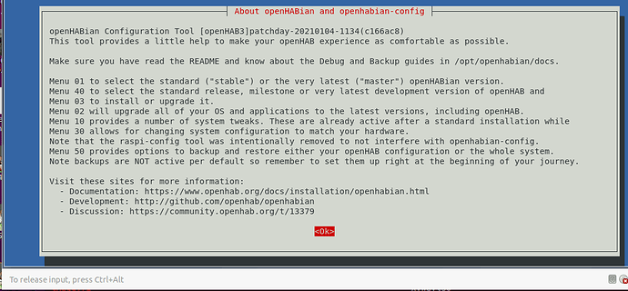

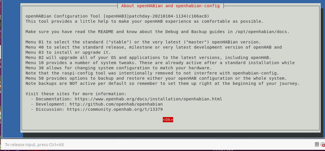

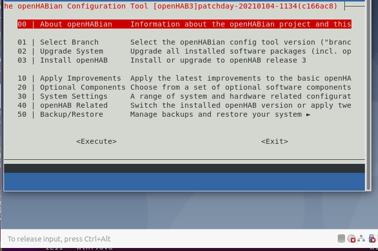

Please have a look at these two screenshots from openhabian-config.
The first is the main menu. First menu entry is the way to get into the about menu.
In the second screenshot in between menu 30 and 50 you find the mentioned information.
