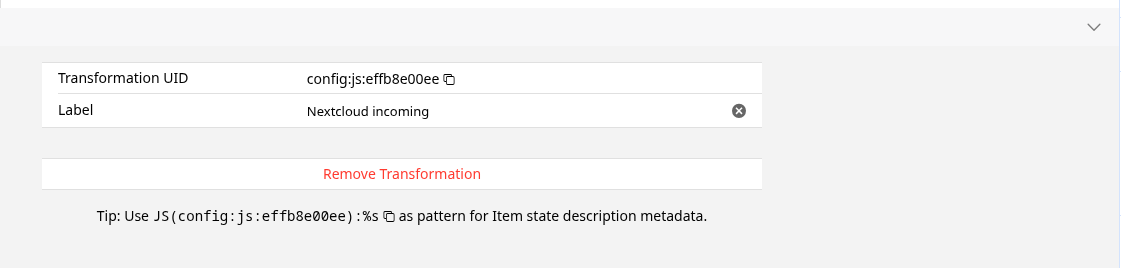

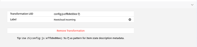

Actually yes, there is. It’s just not very well marked.
When you open up the transform page and see the code of the transform, in the bottom right of the page there is a small blue chevron. Click on that and you will bring up the bottom panel with the transform label and UID (that’s also where the link to remove the transform is).
An issue might still not be a bad idea just to request that this be made a little more clear (it looks like just part of the docs link). You are not the first to miss this and it’s on more than just the transform page.
:smiley: Wonderful Justin! I would not have found this by myself at all, it really is hidden! And I’ll make sure to check for the chevron on other pages too :wink:
