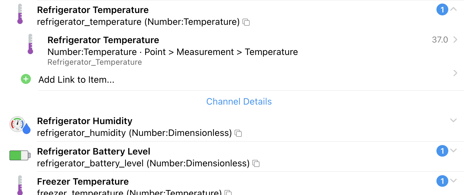

I’m using several Inkbird BLE thermometers via ESPhome – the ESP32 device captures the BLE broadcasts and they show up in OpenHab via the ESPhome binding with channels for temperature, humidty, and battery level.
The same ESP32 captures broadcasts from my RadonEye radon monitor.
