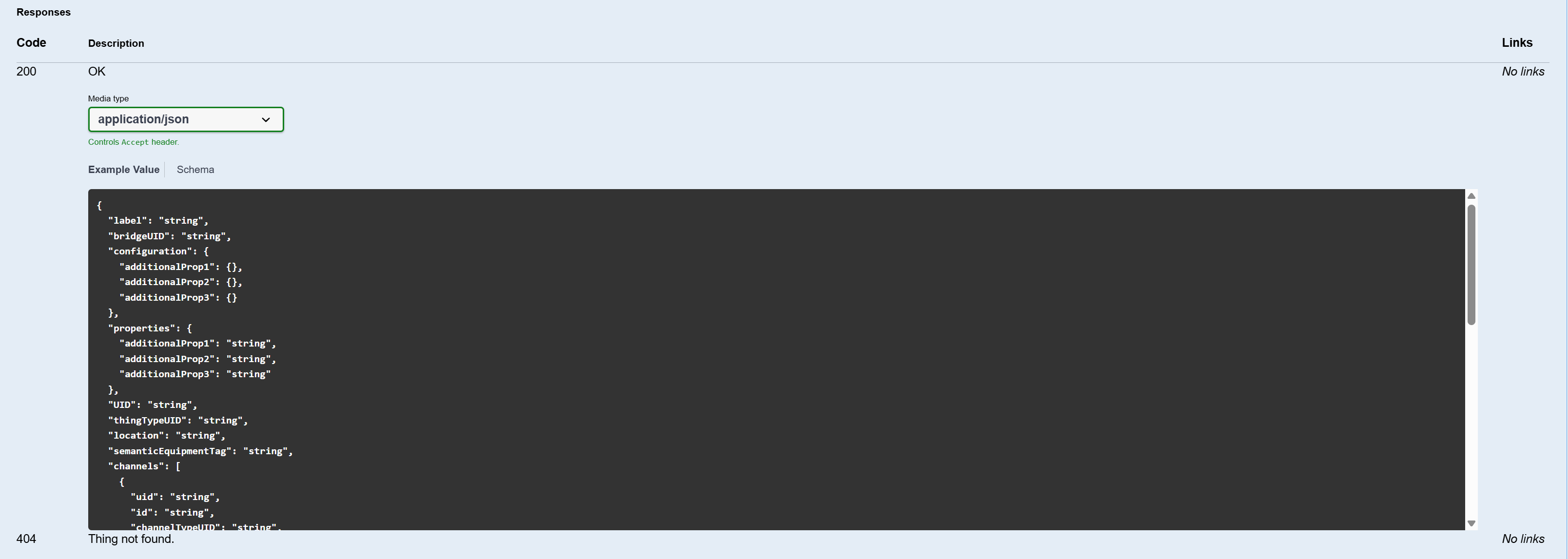

Edit on 30.08.2026:
If i use the openHAB API explorer, i get the following responses. First a 200 OK and finally a 400 “thing not found”.
If i use the https:// link with my device ID in a browser, i get a “500 internal server error” → nginx.
device not found from the cloud usually means the token is fine but the appliance isnt attached to that account anymore, so the 400 in the api explorer tracks. hit /v1/devices with your token first, if the machine isnt in that list its nothing to do with openhab. if it is listed then the thing UID is stale, delete the miele thing and let it rediscover after the bridge re-auths. also grep the log for 401/403, once the refresh dies the binding just keeps spamming.
