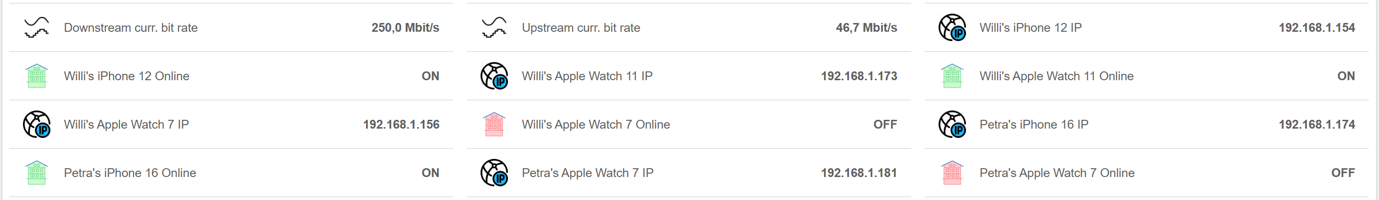

Am running OH 5.2.0-SNAPSHOT #5251. Use 5 different MAC adresses for IP and presence detection of the related devices. Directly after enabling the LAN sub device thing, the result looks like this and 5 different IPs are detected:
After the first update (60secs), the IP detection already fails:
Instead of 5 different IPs, the result is three times 192.168.1.156 and two times 192.168.1.181. The presence detection seems not to be affected. But this needs to be further observed. Disabling/enabling of the thing brings up the right IPs once for 60 secs.

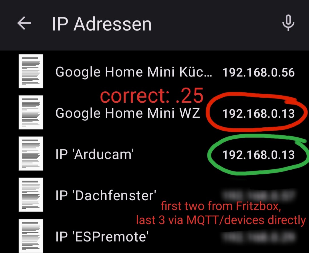

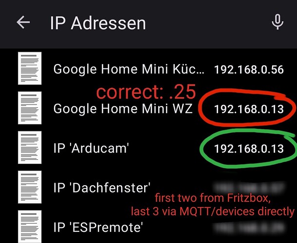

I also had the issue that several devices were reported with the same IPs. But just when I wanted to take a screenshot, I noticed that almost all report the correct IP at the moment - but I removed several devices after I noticed that many looked identical, so I have less items to compare now.
I only have two devices with the same IP shown at the moment: One (ESP8266) reports via MQTT its real IP and the other ones (Google home) are retrieved from my FritzBox. This one should be 25 at the moment, but is reported as 13 as well.
