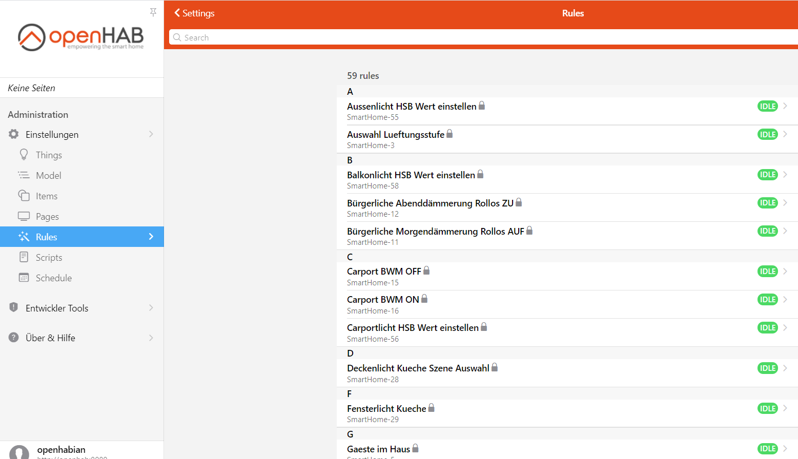

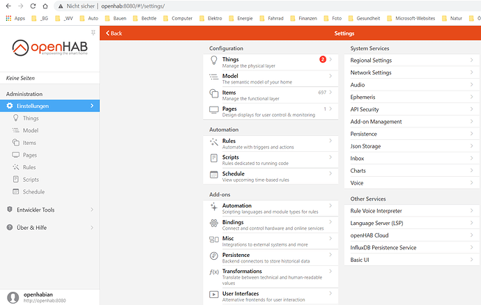

It seems that I have a mixture of OH3 and OH2 after the Upgrade. I did the upgrade in SSH window. After the reboot after the upgrade I saw the OH3 startup screen in the SSH window. After another reboot I saw the OH2.5.11 startup screen again. Within the browser I see OH3 with the importet items and rules.

Within the SSH session inconsistent messages about the running version:
After SSH Login “openHAB 2.5.11-1 ()” and in openHAB CLI console “3.0.0 - Release Build”
