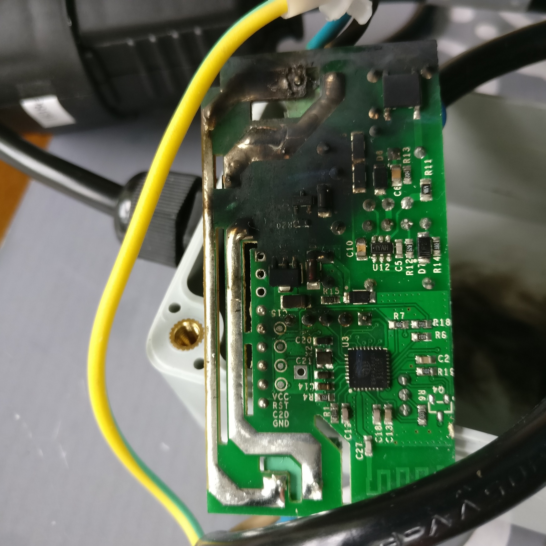

2 out of 4 devices I ordered, S20 and smart switch, are not working anymore within a year (and their warrant period is only 90 days).
One defect worries me a lot because it almost started a fire (the power switched by the device was well below the maximum). So I am looking for a better quality alternative

I did a bit of reading into this.
It looks like the overheating PCB problem is due to lack of manufacturing control over the tinning of the PCB carrying the load current (at mains voltage).
The copper tracks themselves aren’t thick enough so they add extra solder by hand to increase the thickness and lower the impedance.
The problem here is that ‘adding’ some more tin by hand’ is a procedure that is difficult to control and measure.
If your board doesn’t have enough and the load is large enough then it could overheat.
(There was a recall for this problem).
CE certification (once the initial sample testing has been conducted), is basically self-certification by the manufacturer.
Putting it another way, the devices could have a ream of safety certificates and still overheat.
UL certification on the other hand, and to exactly the same standards, also requires yearly factory inspections and monitoring of assembly procedures. The lack of control over the hand-tinning of the tracks would almost definitely have been picked up.
As an example of a more controlled and repeatable process, a PCB with thicker and wider copper tracks would do it, possibly with a larger PCB and hence device footprint and greater cost.
In summary, I’d probably suggest that people periodically check the PCBs of their sonoff devices (with the power disconnected) and check for any burning. especially if they are using them for higher loads such as heaters.

What kind of load you had on that switch? As I see from my Sonoff Touch, the PCB has quite big creepage distances, so they shouldn’t cause any problem. In your case I see that connector pin melt out, so it looks like overloading was the cause.

@Artyom_Syomushkin The device that was connected to the sonoff has a maximum power of 1800 Watt (so about 7.8 A). Maybe the tinning is an issue causing overloading below the specifications.

That article reckons the fuse holder is at fault. It’s difficult to tell whether the overheating is from the tracks as I described before or from the actual fuse holder overheating.
I’m surprised, in the EN60669-1 test report that the fuse holders are not mentioned in the critical component list of the report. I don’t have a copy of EN60669-1 but from previous experience, fuse holders are always included in the report and should be a named part (manufacturer and part number).
This is not the case here which to me, makes the whole report a little bit suspect.
