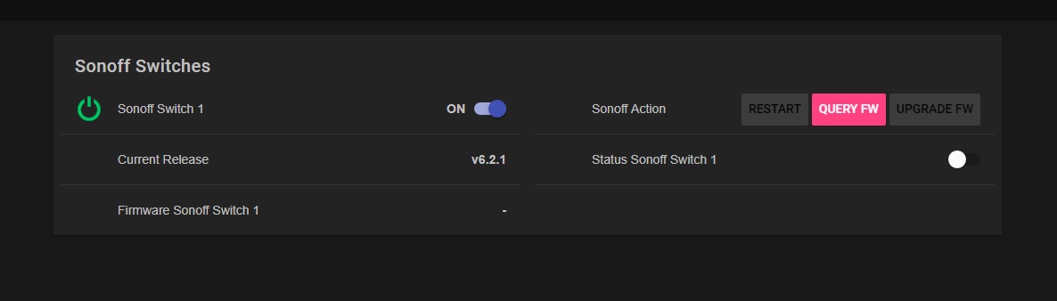

well, this is the picture under my basic UI
clicking on the sonoff action buttons dont seem to do anything.
I cannot see the current firmware of my sonoff switch , which is 6.11 btw
And I dunno why there is a on/ooff switch next to the status of Sonoff Switch 1
In the rule you are using your OH-Item-Name for the Sonoff not the sonoff internal one (sonoff-AEI).
Use some more logInfo lines in order to see what is working and what not.
On the On/Off on the sitemap: You have configured a switch, that On/Off is the control which you can use to toggle on the sitemap.
sorry, where is the OH-Item-Name you are referring to?
Can I get the status to display…just the status instead of being a switch?
Thank you
