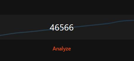

ok, I have a item number readed:
but there is scale factor 100 so correct value is 456,66
if I will use a gain 0.01 value is 466 (missing decimal points)
and in the metadata / state description / pattern, don’t know if exist any function
next chance is transform somehow in the rule where I’m using deltaSince function
so I tried multiply by 0.01 but result of deltaSince isn’t 7.3 but 7.300 (before multiply was 730)
ok, thanks
Is there any output how to get from the readed value 46566 a value 465,66 with the gain ?
Or I must use a rule and recalculate all values ?
The multiplier fits, this scales the incoming value properly.
Did you set the state description for your item?
There you can format the output value. Maybe here the decimals are missing.
“%.2f” should result in two decimals being shown for the item.
Could you post your item and your channel definition?
ok, on the end I found a solution
gain I set to 0.01 and state state description in the metadata I set to %.2f
Then value is ok, but quite complicated solution
