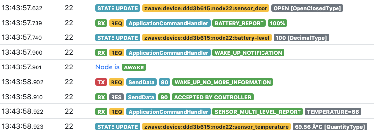

Thanks Bruce. Here is the Debug Log:
2020-11-05 13:43:57.631 [DEBUG] [nal.protocol.ZWaveTransactionManager] - processReceiveMessage input 0<>128 : Message: class=ApplicationCommandHandler[4], type=Request[0], dest=22, callback=0, payload=00 16 09 71 05 00 00 00 FF 06 16 00
2020-11-05 13:43:57.631 [DEBUG] [nal.protocol.ZWaveTransactionManager] - Received msg (0): Message: class=ApplicationCommandHandler[4], type=Request[0], dest=22, callback=0, payload=00 16 09 71 05 00 00 00 FF 06 16 00
2020-11-05 13:43:57.631 [DEBUG] [nal.protocol.ZWaveTransactionManager] - lastTransaction TID 2579: [WAIT_REQUEST] priority=Poll, requiresResponse=true, callback: 88
2020-11-05 13:43:57.631 [DEBUG] [nal.protocol.ZWaveTransactionManager] - NODE 22: Application Command Request (ALIVE:DONE)
2020-11-05 13:43:57.631 [DEBUG] [ng.zwave.internal.protocol.ZWaveNode] - NODE 22: resetResendCount initComplete=true isDead=false
2020-11-05 13:43:57.631 [DEBUG] [ng.zwave.internal.protocol.ZWaveNode] - NODE 22: Incoming command class COMMAND_CLASS_ALARM, endpoint 0
2020-11-05 13:43:57.631 [DEBUG] [ng.zwave.internal.protocol.ZWaveNode] - NODE 22: SECURITY NOT required on COMMAND_CLASS_ALARM
2020-11-05 13:43:57.631 [DEBUG] [tocol.commandclass.ZWaveCommandClass] - NODE 22: Received COMMAND_CLASS_ALARM V5 NOTIFICATION_REPORT
2020-11-05 13:43:57.631 [DEBUG] [.commandclass.ZWaveAlarmCommandClass] - NODE 22: NOTIFICATION report - 0 = 0, event=22, status=255, plen=0
2020-11-05 13:43:57.631 [DEBUG] [.commandclass.ZWaveAlarmCommandClass] - NODE 22: Alarm Type = ACCESS_CONTROL (0)
2020-11-05 13:43:57.631 [DEBUG] [ding.zwave.handler.ZWaveThingHandler] - NODE 22: Got an event from Z-Wave network: ZWaveAlarmValueEvent
2020-11-05 13:43:57.631 [DEBUG] [ding.zwave.handler.ZWaveThingHandler] - NODE 22: Got a value event from Z-Wave network, endpoint=0, command class=COMMAND_CLASS_ALARM, value=255
2020-11-05 13:43:57.631 [DEBUG] [ternal.converter.ZWaveAlarmConverter] - NODE 22: Alarm converter processing NOTIFICATION
2020-11-05 13:43:57.631 [DEBUG] [ternal.converter.ZWaveAlarmConverter] - NODE 22: Alarm converter NOTIFICATION event is 22, type OpenClosedType
2020-11-05 13:43:57.632 [DEBUG] [ding.zwave.handler.ZWaveThingHandler] - NODE 22: Updating channel state zwave:device:ddd3b615:node22:sensor_door to OPEN [OpenClosedType]
2020-11-05 13:43:57.632 [DEBUG] [ternal.converter.ZWaveAlarmConverter] - NODE 22: Alarm converter processing NOTIFICATION
2020-11-05 13:43:57.632 [DEBUG] [ternal.converter.ZWaveAlarmConverter] - NODE 22: Alarm converter NOTIFICATION event is 22, type OnOffType
2020-11-05 13:43:57.632 [DEBUG] [nal.protocol.ZWaveTransactionManager] - NODE 22: Commands processed 1.
2020-11-05 13:43:57.632 [DEBUG] [nal.protocol.ZWaveTransactionManager] - NODE 22: Checking command org.openhab.binding.zwave.internal.protocol.ZWaveCommandClassPayload@2fb8ec4a.
2020-11-05 13:43:57.632 [DEBUG] [nal.protocol.ZWaveTransactionManager] - Transaction completed - outstandingTransactions 1
2020-11-05 13:43:57.632 [DEBUG] [nal.protocol.ZWaveTransactionManager] - ZWaveReceiveThread queue empty
2020-11-05 13:43:57.632 [DEBUG] [nal.protocol.ZWaveTransactionManager] - Transaction SendNextMessage 1 out at start. Holdoff false.
2020-11-05 13:43:57.739 [DEBUG] [WaveSerialHandler$ZWaveReceiveThread] - Receive Message = 01 09 00 04 00 16 03 80 03 64 00
2020-11-05 13:43:57.739 [DEBUG] [nal.protocol.ZWaveTransactionManager] - processReceiveMessage input 0<>128 : Message: class=ApplicationCommandHandler[4], type=Request[0], dest=22, callback=0, payload=00 16 03 80 03 64
2020-11-05 13:43:57.740 [DEBUG] [nal.protocol.ZWaveTransactionManager] - Received msg (0): Message: class=ApplicationCommandHandler[4], type=Request[0], dest=22, callback=0, payload=00 16 03 80 03 64
2020-11-05 13:43:57.740 [DEBUG] [nal.protocol.ZWaveTransactionManager] - lastTransaction TID 2579: [WAIT_REQUEST] priority=Poll, requiresResponse=true, callback: 88
2020-11-05 13:43:57.740 [DEBUG] [nal.protocol.ZWaveTransactionManager] - NODE 22: Application Command Request (ALIVE:DONE)
2020-11-05 13:43:57.740 [DEBUG] [ng.zwave.internal.protocol.ZWaveNode] - NODE 22: resetResendCount initComplete=true isDead=false
2020-11-05 13:43:57.740 [DEBUG] [ng.zwave.internal.protocol.ZWaveNode] - NODE 22: Incoming command class COMMAND_CLASS_BATTERY, endpoint 0
2020-11-05 13:43:57.740 [DEBUG] [ng.zwave.internal.protocol.ZWaveNode] - NODE 22: SECURITY NOT required on COMMAND_CLASS_BATTERY
2020-11-05 13:43:57.740 [DEBUG] [tocol.commandclass.ZWaveCommandClass] - NODE 22: Received COMMAND_CLASS_BATTERY V1 BATTERY_REPORT
2020-11-05 13:43:57.740 [DEBUG] [ommandclass.ZWaveBatteryCommandClass] - NODE 22: Battery report value = 100
2020-11-05 13:43:57.740 [DEBUG] [ding.zwave.handler.ZWaveThingHandler] - NODE 22: Got an event from Z-Wave network: ZWaveCommandClassValueEvent
2020-11-05 13:43:57.740 [DEBUG] [ding.zwave.handler.ZWaveThingHandler] - NODE 22: Got a value event from Z-Wave network, endpoint=0, command class=COMMAND_CLASS_BATTERY, value=100
2020-11-05 13:43:57.740 [DEBUG] [ding.zwave.handler.ZWaveThingHandler] - NODE 22: Updating channel state zwave:device:ddd3b615:node22:battery-level to 100 [DecimalType]
2020-11-05 13:43:57.740 [DEBUG] [nal.protocol.ZWaveTransactionManager] - NODE 22: Commands processed 1.
2020-11-05 13:43:57.740 [DEBUG] [nal.protocol.ZWaveTransactionManager] - NODE 22: Checking command org.openhab.binding.zwave.internal.protocol.ZWaveCommandClassPayload@389d9202.
2020-11-05 13:43:57.740 [DEBUG] [nal.protocol.ZWaveTransactionManager] - Transaction completed - outstandingTransactions 1
2020-11-05 13:43:57.740 [DEBUG] [nal.protocol.ZWaveTransactionManager] - ZWaveReceiveThread queue empty
2020-11-05 13:43:57.740 [DEBUG] [nal.protocol.ZWaveTransactionManager] - Transaction SendNextMessage 1 out at start. Holdoff false.
2020-11-05 13:43:57.804 [DEBUG] [WaveSerialHandler$ZWaveReceiveThread] - Receive Message = 01 07 00 13 58 01 00 28 9A
2020-11-05 13:43:57.804 [DEBUG] [nal.protocol.ZWaveTransactionManager] - processReceiveMessage input 0<>128 : Message: class=SendData[19], type=Request[0], dest=1, callback=88, payload=58 01 00 28
2020-11-05 13:43:57.804 [DEBUG] [nal.protocol.ZWaveTransactionManager] - Received msg (0): Message: class=SendData[19], type=Request[0], dest=1, callback=88, payload=58 01 00 28
2020-11-05 13:43:57.804 [DEBUG] [nal.protocol.ZWaveTransactionManager] - lastTransaction TID 2579: [WAIT_REQUEST] priority=Poll, requiresResponse=true, callback: 88
2020-11-05 13:43:57.804 [DEBUG] [nal.protocol.ZWaveTransactionManager] - Checking outstanding transactions: 1
2020-11-05 13:43:57.804 [DEBUG] [nal.protocol.ZWaveTransactionManager] - Last transaction: TID 2579: [WAIT_REQUEST] priority=Poll, requiresResponse=true, callback: 88
2020-11-05 13:43:57.804 [DEBUG] [nal.protocol.ZWaveTransactionManager] - Checking TID 2579: (Callback 88)
2020-11-05 13:43:57.804 [DEBUG] [.serialmessage.ZWaveCommandProcessor] - Callback match!
2020-11-05 13:43:57.804 [DEBUG] [nal.protocol.ZWaveTransactionManager] - Correlated to TID 2579: callback 88
2020-11-05 13:43:57.804 [DEBUG] [ve.internal.protocol.ZWaveController] - Incoming Message: Message: class=SendData[19], type=Request[0], dest=1, callback=88, payload=58 01 00 28
2020-11-05 13:43:57.804 [DEBUG] [l.serialmessage.SendDataMessageClass] - NODE 4: SendData Request. CallBack ID = 88, Status = Transmission complete, no ACK received(1)
2020-11-05 13:43:57.804 [DEBUG] [e.internal.protocol.ZWaveTransaction] - TID 2579: Transaction CANCELLED
2020-11-05 13:43:57.805 [DEBUG] [nal.protocol.ZWaveTransactionManager] - NODE 4: CANCEL while sending message. Requeueing - 1 attempts left!
2020-11-05 13:43:57.805 [DEBUG] [e.internal.protocol.ZWaveTransaction] - TID 2579: Transaction RESET with 1 retries remaining.
2020-11-05 13:43:57.805 [DEBUG] [nal.protocol.ZWaveTransactionManager] - NODE 4: Adding to device queue
2020-11-05 13:43:57.805 [DEBUG] [nal.protocol.ZWaveTransactionManager] - NODE 4: Added 2579 to queue - size 9
2020-11-05 13:43:57.805 [DEBUG] [nal.protocol.ZWaveTransactionManager] - Transaction SendNextMessage 0 out at start. Holdoff false.
2020-11-05 13:43:57.805 [DEBUG] [wave.internal.protocol.SerialMessage] - Assembled message buffer = 01 08 00 13 04 01 00 25 59 9D
2020-11-05 13:43:57.805 [DEBUG] [ing.zwave.handler.ZWaveSerialHandler] - NODE 4: Sending REQUEST Message = 01 08 00 13 04 01 00 25 59 9D
2020-11-05 13:43:57.805 [DEBUG] [ing.zwave.handler.ZWaveSerialHandler] - Message SENT
2020-11-05 13:43:57.805 [DEBUG] [nal.protocol.ZWaveTransactionManager] - Transaction SendNextMessage started: TID 2579: [WAIT_RESPONSE] priority=Poll, requiresResponse=true, callback: 89
2020-11-05 13:43:57.805 [DEBUG] [nal.protocol.ZWaveTransactionManager] - NODE 4: TID 2579: Transaction not completed
2020-11-05 13:43:57.805 [DEBUG] [nal.protocol.ZWaveTransactionManager] - ZWaveReceiveThread queue empty
2020-11-05 13:43:57.805 [DEBUG] [nal.protocol.ZWaveTransactionManager] - Transaction SendNextMessage 1 out at start. Holdoff false.
2020-11-05 13:43:57.806 [DEBUG] [WaveSerialHandler$ZWaveReceiveThread] - Receive Message = 06
2020-11-05 13:43:57.806 [DEBUG] [nal.protocol.ZWaveTransactionManager] - processReceiveMessage input 0<>128 : Message: class=null[0], type=ACK[2], dest=255, callback=0, payload=
2020-11-05 13:43:57.806 [DEBUG] [nal.protocol.ZWaveTransactionManager] - Received msg (0): Message: class=null[0], type=ACK[2], dest=255, callback=0, payload=
2020-11-05 13:43:57.806 [DEBUG] [nal.protocol.ZWaveTransactionManager] - lastTransaction TID 2579: [WAIT_RESPONSE] priority=Poll, requiresResponse=true, callback: 89
2020-11-05 13:43:57.806 [DEBUG] [nal.protocol.ZWaveTransactionManager] - Received msg: ACK
2020-11-05 13:43:57.806 [DEBUG] [nal.protocol.ZWaveTransactionManager] - ZWaveReceiveThread queue empty
2020-11-05 13:43:57.806 [DEBUG] [nal.protocol.ZWaveTransactionManager] - Transaction SendNextMessage 1 out at start. Holdoff false.
2020-11-05 13:43:57.815 [DEBUG] [WaveSerialHandler$ZWaveReceiveThread] - Receive Message = 01 04 01 13 01 E8
2020-11-05 13:43:57.815 [DEBUG] [nal.protocol.ZWaveTransactionManager] - processReceiveMessage input 0<>128 : Message: class=SendData[19], type=Response[1], dest=255, callback=0, payload=01
2020-11-05 13:43:57.815 [DEBUG] [nal.protocol.ZWaveTransactionManager] - Received msg (0): Message: class=SendData[19], type=Response[1], dest=255, callback=0, payload=01
2020-11-05 13:43:57.815 [DEBUG] [nal.protocol.ZWaveTransactionManager] - lastTransaction TID 2579: [WAIT_RESPONSE] priority=Poll, requiresResponse=true, callback: 89
2020-11-05 13:43:57.815 [DEBUG] [nal.protocol.ZWaveTransactionManager] - Checking outstanding transactions: 1
2020-11-05 13:43:57.816 [DEBUG] [nal.protocol.ZWaveTransactionManager] - Last transaction: TID 2579: [WAIT_RESPONSE] priority=Poll, requiresResponse=true, callback: 89
2020-11-05 13:43:57.816 [DEBUG] [ve.internal.protocol.ZWaveController] - Incoming Message: Message: class=SendData[19], type=Response[1], dest=255, callback=0, payload=01
2020-11-05 13:43:57.816 [DEBUG] [l.serialmessage.SendDataMessageClass] - NODE 4: sentData successfully placed on stack.
2020-11-05 13:43:57.816 [DEBUG] [nal.protocol.ZWaveTransactionManager] - TID 2579: Advanced to WAIT_REQUEST
2020-11-05 13:43:57.816 [DEBUG] [nal.protocol.ZWaveTransactionManager] - NODE 4: TID 2579: Transaction not completed
2020-11-05 13:43:57.816 [DEBUG] [nal.protocol.ZWaveTransactionManager] - ZWaveReceiveThread queue empty
2020-11-05 13:43:57.816 [DEBUG] [nal.protocol.ZWaveTransactionManager] - Transaction SendNextMessage 1 out at start. Holdoff false.
2020-11-05 13:43:57.900 [DEBUG] [WaveSerialHandler$ZWaveReceiveThread] - Receive Message = 01 08 00 04 00 16 02 84 07 64
2020-11-05 13:43:57.900 [DEBUG] [nal.protocol.ZWaveTransactionManager] - processReceiveMessage input 0<>128 : Message: class=ApplicationCommandHandler[4], type=Request[0], dest=22, callback=0, payload=00 16 02 84 07
2020-11-05 13:43:57.900 [DEBUG] [nal.protocol.ZWaveTransactionManager] - Received msg (0): Message: class=ApplicationCommandHandler[4], type=Request[0], dest=22, callback=0, payload=00 16 02 84 07
2020-11-05 13:43:57.900 [DEBUG] [nal.protocol.ZWaveTransactionManager] - lastTransaction TID 2579: [WAIT_REQUEST] priority=Poll, requiresResponse=true, callback: 89
2020-11-05 13:43:57.901 [DEBUG] [nal.protocol.ZWaveTransactionManager] - NODE 22: Application Command Request (ALIVE:DONE)
2020-11-05 13:43:57.901 [DEBUG] [ng.zwave.internal.protocol.ZWaveNode] - NODE 22: resetResendCount initComplete=true isDead=false
2020-11-05 13:43:57.901 [DEBUG] [ng.zwave.internal.protocol.ZWaveNode] - NODE 22: Is awake with 0 messages in the queue
2020-11-05 13:43:57.901 [DEBUG] [ng.zwave.internal.protocol.ZWaveNode] - NODE 22: Start sleep timer at 1000ms
2020-11-05 13:43:57.901 [DEBUG] [ding.zwave.handler.ZWaveThingHandler] - NODE 22: Got an event from Z-Wave network: ZWaveNodeStatusEvent
2020-11-05 13:43:57.901 [DEBUG] [ding.zwave.handler.ZWaveThingHandler] - NODE 22: Channel zwave:device:ddd3b615:node22:scene_number unlinked - polling stopped.
2020-11-05 13:43:57.902 [DEBUG] [ding.zwave.handler.ZWaveThingHandler] - NODE 22: Channel zwave:device:ddd3b615:node22:sensor_binary unlinked - polling stopped.

For time reference here is the corresponding event.log
2020-11-05 13:43:57.905 [vent.ItemStateChangedEvent] - zwave_device_ddd3b615_node22_sensor_binary changed from NULL to ON
2020-11-05 13:43:57.907 [vent.ItemStateChangedEvent] - zwave_device_ddd3b615_node22_sensor_temperature changed from NULL to 69.75 °C
2020-11-05 13:43:57.909 [vent.ItemStateChangedEvent] - zwave_device_ddd3b615_node22_sensor_door changed from NULL to OPEN
2020-11-05 13:43:57.912 [vent.ItemStateChangedEvent] - zwave_device_ddd3b615_node22_battery_level changed from NULL to 100.0
2020-11-05 13:43:57.917 [vent.ItemStateChangedEvent] - zwave_device_ddd3b615_node22_alarm_general changed from NULL to ON
2020-11-05 13:43:57.917 [me.event.ThingUpdatedEvent] - Thing 'zwave:device:ddd3b615:node22' has been updated.
2020-11-05 13:43:58.924 [vent.ItemStateChangedEvent] - zwave_device_ddd3b615_node22_sensor_temperature changed from 69.75 °C to 69.56 °C
2020-11-05 13:43:58.923 [DEBUG] [ding.zwave.handler.ZWaveThingHandler] - NODE 22: Updating channel state zwave:device:ddd3b615:node22:sensor_temperature to 69.56 °C [QuantityType]
This is all that the binding is doing - from the binding perspective, there is the following activity -:
What’s happening outside of the binding I can’t really say - maybe a broader debug log would help. I do tend to agree that it looks like the thing is being reset, but I don’t think it’s because the binding is updating the properties - if it is, then I’d suggest that’s a bug as it’s done a lot and relinking channels every time a property is updated would not be correct.

However I was able to maybe move a step ahead. The change from NULL to value behavior is only there when either a wake-up is initiated or when the “interval for XYZ report” of the zwave device is triggered. If the device sends a report based on a “XYZ report threshold” then the behaviour is as expected.
Here is the sample:
When “interval for temperature report triggers” the behavior is:
2020-11-05 22:51:50.370 [vent.ItemStateChangedEvent] - zwave_device_ddd3b615_node22_sensor_binary changed from NULL to ON

When “temperature report threshold” the behavior is:
zwave_device_ddd3b615_node22_sensor_temperature changed from 26.18 °C to 25.56 °C
Not sure what conclusion to draw from this, but wanted to share it.
This does not enable debug logging - hence why you got no debug logs. This enables debug access to the JVM only.
To enable debug logging, you need to enable it through the console with the log:set debug * (I think) command.
Thanks Chris. debug * didnt work but I did it manually for all modules… I also had to remove (grep -v -i http) lines, to shorten a bit the large log size. Hope this is not removing anything of relevance.
Here is the result for that one second in which the unlinking happens (2020-11-06 00:23:15.452):
https://pastebin.ubuntu.com/p/8sQTGnzT6j/
Any hints you can provide?
I don’t really see anything that jumps out. The unlinking doesn’t happen on all updates - it would be good to be a longer log to try and establish a pattern. In this log, it only seems to happen on the wakeup report. However this log is very short with all received messages coming in within around 200ms. This could therefore be misleading if there was a small delay in processing elsewhere, or there was something that happened just before.
I looked at the wakeup event in the binding and can’t see that it is doing anything special - it does update the properties to set the last wakeup time, so it could well be that somewhere else in the system the items are all being reset (as suggested by @rossko57). IMHO if this is the case it’s not correct - updating properties about a Thing should not reset the Items to null (if this is what is happening).
Thanks Chris! Much appreciated.
Here is a 3 minute DEBUG log around the same event. Hope you can identify something:
https://pastebin.ubuntu.com/p/pr2BjjHGqr/
