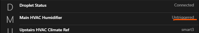

Item State displayed in 2 different ways?
OH 5.1.1 running on RPi5 configured entirely with Main UI
I used an old Z-wave sensor device to capture the state of my HVAC system.
In the Event log it shows states of ON/OFF but the Item state displayed in the UI is triggered/untriggered.
In the Item list in Settings it shows ON/OFF
I would prefer to use ON/OFF.
What’s the easiest way to achieve this?
