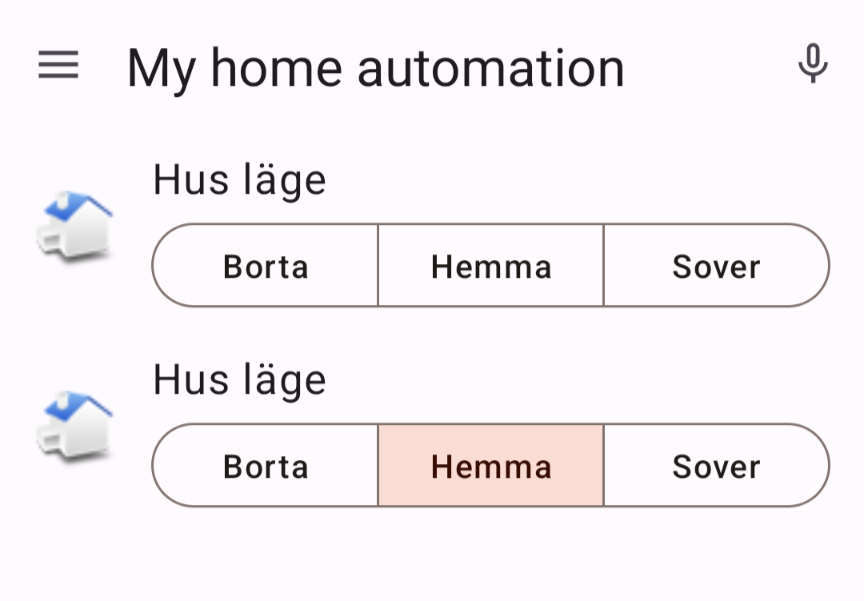

If I have stateDescription set for an item, should that work with sitemaps so it shows the current state of the item?
For me it don’t seem so. But if I add mappings to the sitemap it works.
.items
Number House_Mode "Hus läge" <house> {stateDescription="" [options="0=Borta, 1=Hemma, 2=Sover"]}
.sitemap
sitemap test label="My home automation" {
        Switch item=House_Mode
        Switch item=House_Mode mappings=[0="Borta", 1="Hemma", 2="Sover"]
Please confirm using Basic UI.

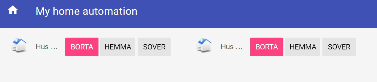

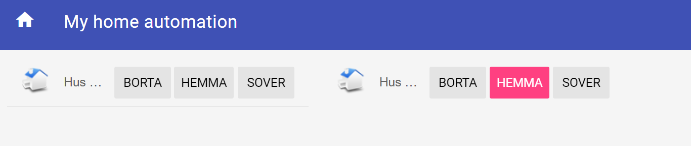

Same issue in Basic UI.
Is it different if the item is of type String ?
I will debug your current use case.

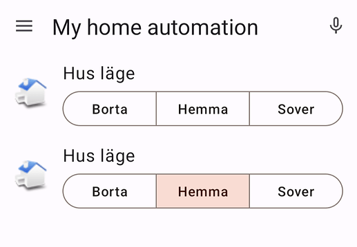

With item type as String it works!
String House_Mode1 "Hus läge" <house> {stateDescription="" [options="0=Borta, 1=Hemma, 2=Sover"]}
        Switch item=House_Mode1
        Switch item=House_Mode1 mappings=[0="Borta", 1="Hemma", 2="Sover"]

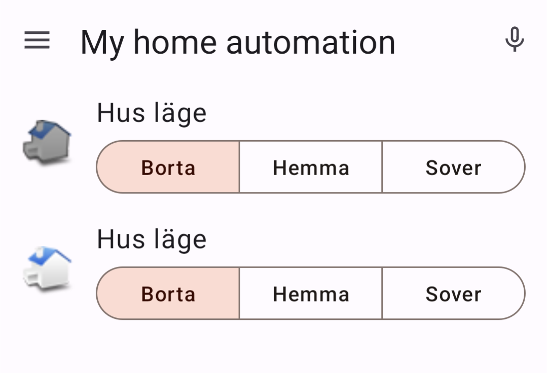

I noticed that dynamic icon works with Switch item=House_Mode1 (but not with Switch item=House_Mode1 mappings=[0="Borta", 1="Hemma", 2="Sover"] )
In Basic UI there is no dynamic icon at all.

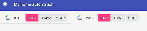

Nice! Thanks for the help!
Even if I was already 99.9% sure, I checked the icon URL requested by Basic UI and I can confirm that state in URL is 0, 1 or 2, not depending on whether you set state options or not.
Fix is now merged and will be available in next snapshot tomorrow.
