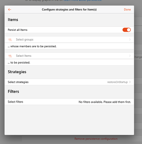

With restoreOnStartup strategy :
Problem is that after OpenHAB restart is value of this items NULL.
What’s wrong ? Or I must somehow restore values manually ?

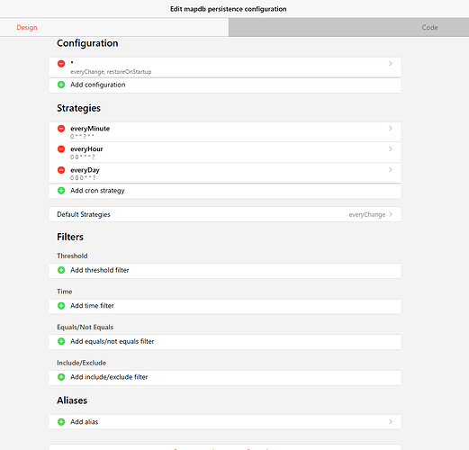

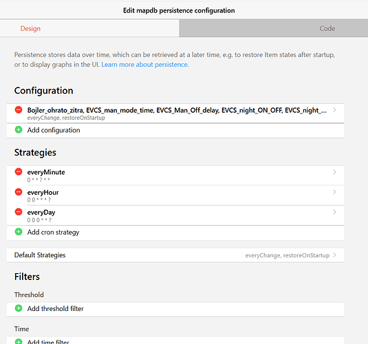

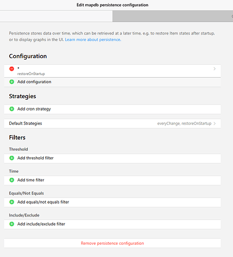

ok, like this ? :
so now both will work prallel ?
MapDB as backup for reboot and RRD4J for historic data ?
Yes !!
No, you have missed everyChange…

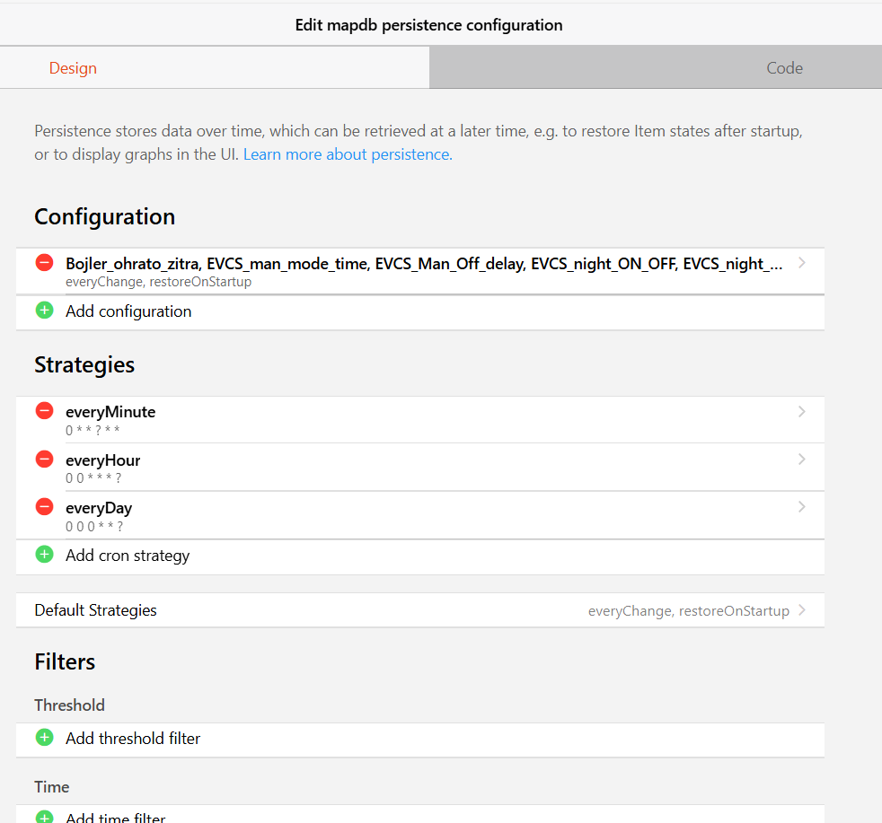

This is my config:
You need everyChange to have the last state in mapDB. For Synchronization, please add “everyMinute” for a couple of minutes, otherwise you might miss some items that do not get changed so often.

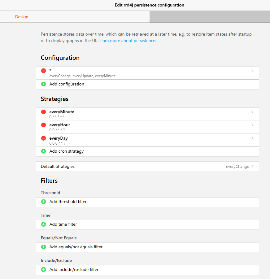

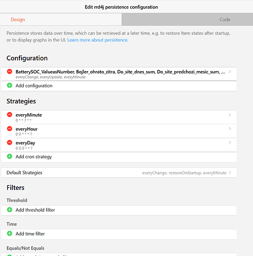

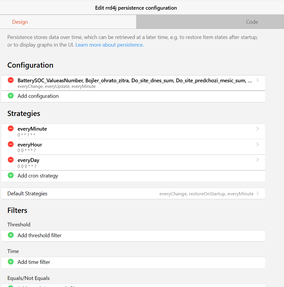

And this is my rrd4j config

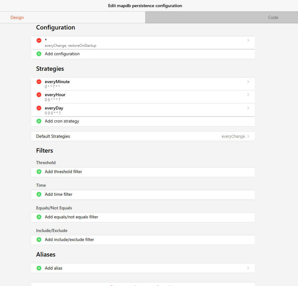

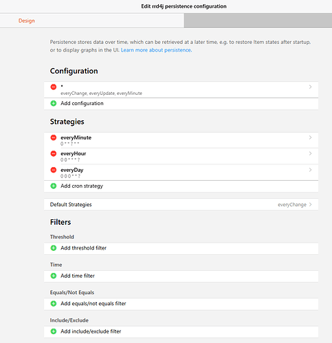

I changed according to your pictures (I hope so):

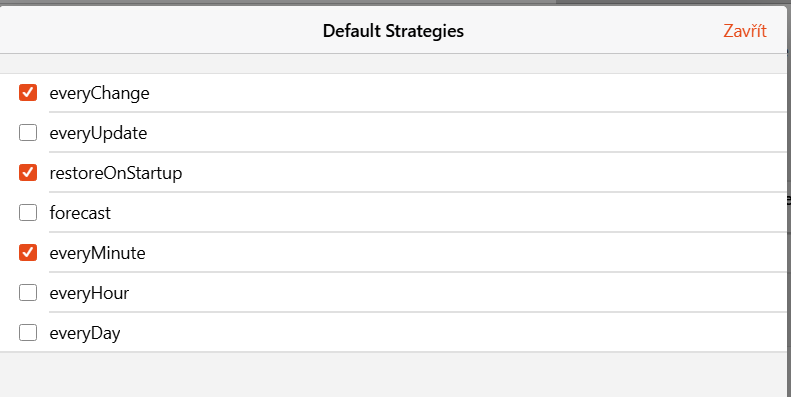

for MapDB isn’t necessary everyUpdate strategy ?
No, as an update could have the same value.
