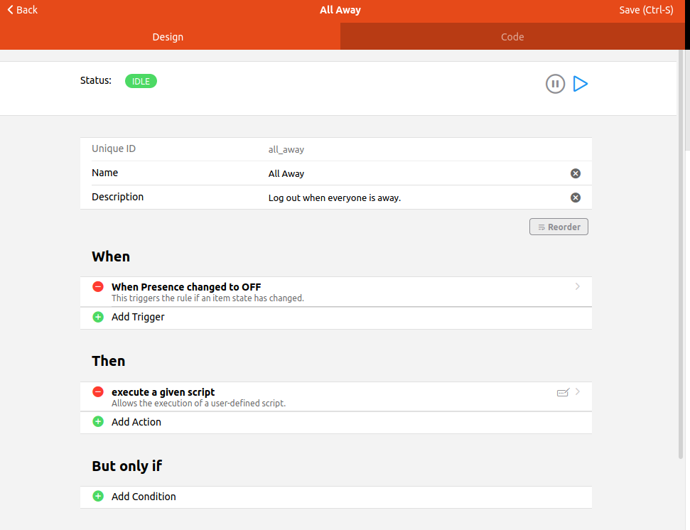

I want to write a rule with if/else conditions. I can do that using “execute a given script”. I’m trying out blockly, but i can’t figure out how to add items.
“Add an Item” doesn’t really say anything. You don’t just add an Item to a script. You do something with it, such as comparing it to another value or send a command to it or the like.

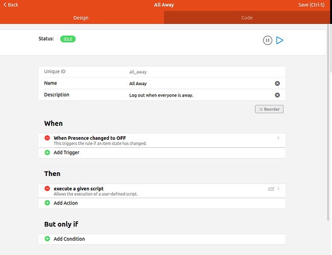

Trigger is outside the Script Action. You define that separately.
I imagine that access to other openHAB Actions will be added over time. But at some point users will grow out of what Blockly can provide and will need to transition to actual text based script actions using one of the other languages. Note that Blockly saves as JavaScript and you can see the JavaScript that it generates on the Code tab.

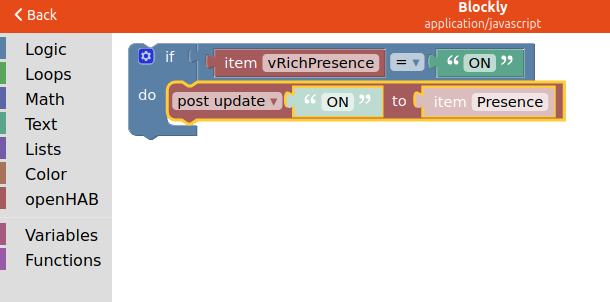

Thanks Rick. You solved my problem. I did not understand that the items are hidden behind the puzzle “item MyItem” in the sectin “opoenHAB”. I know that now. Many Thanks.
Shame on me.
What version of OH are you running? Any version from RC1 or later should look like my screenshot. Earlier versions of the Blockly implementation were more incomplete.
That could be an idea - something that lets you take over the code that Blockly generated (with a warning that you can’t go back).
This was indeed added recently. These “item” blocks are only outputting strings with the name of the item, in fact, so you can replace them with the literal string from the Text tab (the one with quotes). It just helps you with that name by opening the “pick from model” window when you click, so you don’t have to type it yourself.

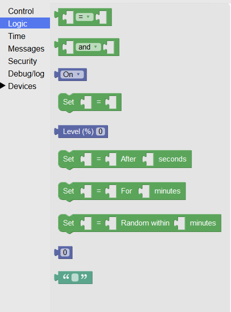

In domoticz there are others componenets that i’d like to have in OpenHab 3 ( in “logic” there are the SET function and more, in addiction the “Time” section and “Messages”, avaiable in Domoticz’sblockly, are not avaiable ).
Time section is very useful for condition creation.
But you have to realize, Blockly is just a think veneer over a text based programming language. In openHAB’s case it’s JavaScript. And most of what you will be doing with Blockly will be done through interacting with openHAB. So have domoticz or any other system that uses Blockly does is no where near as relevant to what is or can be done in openHAB as one might think.
