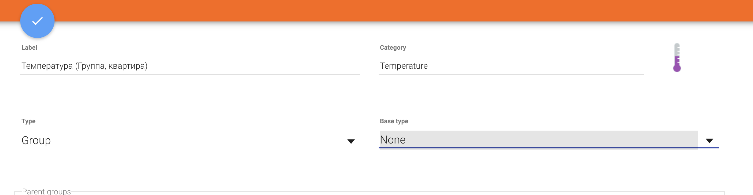

But this definitely was not a display problem, because in logs i saw the records with such errors:
2019-12-16 18:32:21.082 [ERROR] [ntime.internal.engine.RuleEngineImpl] - Rule ‘co2_notification’: Could not cast NULL to java.lang.Number; line 23, column 44, length 32
Here is the line from rule
val minIndoorTemperature = TemperatureGroup.state as Number - 10
State of items, which belong to this group, were updated before, so, group state should be changed to AVG value.
After i changed the base type of group - everything started to work, also this was visible in logs:
2019-12-16 18:49:47.080 [ome.event.ItemUpdatedEvent] - Item ‘TemperatureGroup’ has been updated.
2019-12-16 18:50:40.308 [vent.ItemStateChangedEvent] - LivingRoomAirConditions_LivingRoomTemperature changed from 22.77 °C to 22.72 °C
2019-12-16 18:50:40.313 [GroupItemStateChangedEvent] - TemperatureGroup changed from NULL to 23.71 through LivingRoomAirConditions_LivingRoomTemperature
Can you show us what made you think your Groups had lost their type? (rather than, say, losing the aggregation function?)
Your member Items appear to be Quantity types, with units. Is your Group?
