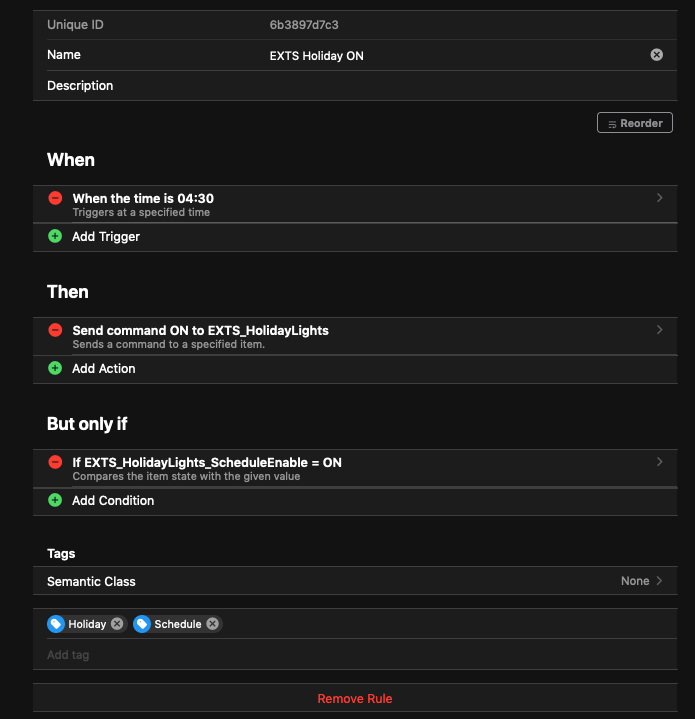

It’s pretty timely that we’re talking about this now, because I just decided to try out a rule in OH3 (running parallel to OH2 and connected via the remote openHAB binding).
Here’s my rule that basically accomplishes the same thing as I described above:
With the new openHAB 3 concepts of Equipment and Points added, I make the Holiday Lights a piece of equipment, with each Z-wave switch and enabler dummy switch a separate point. Here is my model:
