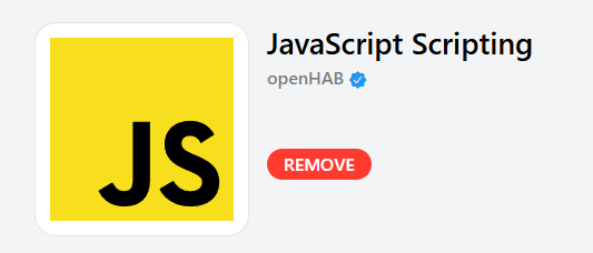

The basic openhab javascript scripting automation is installed:
Could you give hints what am I doing wrong?

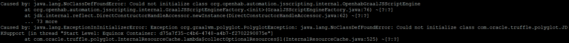

It seems that it is indeed an issue of the JS scripting environment, not that the rules are bad.
I’ve found these exception in the log:
So, the polyglot class is not found for some reason by the openhab environment. As I see the polyglot kar file is in the path ā€œ./var/lib/openhab/tmp/kar/openhab-addons-5.1.0ā€œ. Shouldn’t it be declared in the CLASSPATH?
Ok, so: I’ve missed a log entry in the first place that explains this issue. CPU architecture is not supported (ARM). I am running openhab on a raspberry pi 4 with ARM 32bit.
Do you know if it is possible to have JS scripting for this CPU?
Just FYI openHAB 5.0.0 and newer officially isn’t supported to run on 32 bit OS. Either don’t use JS Scripting (and anything else GraalVM-based) or backup your system and reinstall it to a 64-bit openHABian version. 64-bit also brings a massive speed improvement to JS Scripting compared to running openHAB 4.3.x on 32-bit.
