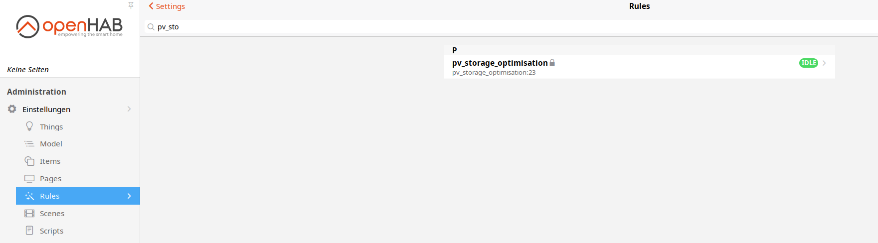

After editing and saving the rule “pv_storage_optimisation” is shown again in the rules section of the openHAB menu after a few moments :
But when I uncomment the line
include OpenHAB::DSL
and I reload the files (the test file and after that the main rule file) then the rule “pv_storage_optimisation” is not shown anymore ?!
And in the log there’s no error or warning message - only the “(Re-)Loading” hint.
