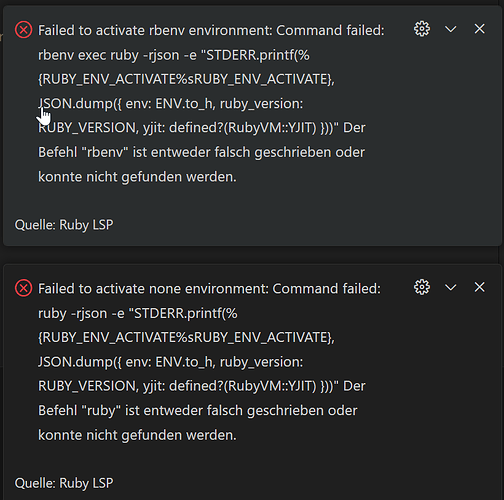

Alrighty, I tell the truth now… I have spent 45 minutes setting up RuboCop and I have absolutely no clue what to do. :smiley: I thought I only need to install it as VSC addon together with Ruby LSP and all is set but nope… It looks like it is a bit more complicated.
Hope someone can help me out.
What OS is your openhab running on?
How do you edit your rules:
  • using vscode + ssh extension (so you’re working “locally” on the openhab server), or
  • accessing them via samba shares, so you’re working on your computer. If this is the case, what OS is your computer?
openHAB runs on openHABian LXC. rules/items I access via a samba share and edit them on my PC using VSC. OS of the PC is Windows 10.
I access the samba as user “openhabian” if this is of any interest.
I don’t have any experience using this in Windows, but several suggestions:
  • Install rbenv (or chruby or any other ruby version manager of your choice)
    • Try accessing the conf folder via Remote - SSH vscode extension. This way you are working on linux / openhab directly. If this is the case, then install rbenv on linux. Probably easiest using the git method, followed by installing ruby-build as plugin.
    • Otherwise, if you choose to continue using samba, you’ll be working on Windows. Perhaps you’d prefer this if you aren’t familiar with Linux. In this case install rbenv for windows

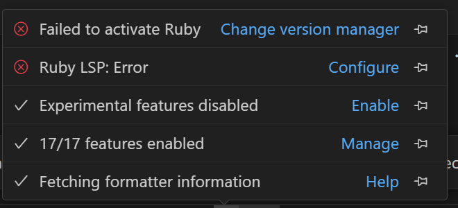

So, for now I’d like to stick to the samba way. If I can’t get it running at all then we shall have a deeper look into the Remote SSH way.
So here is what I did and what worked:
  • Install rbenv for Windows
  • Install ruby 3.1 with rbenv
  • Installed the Gems
  • Added rbenv to the PATH variable
Now, when I go into VSC and restart the Ruby LSP I receive errors that neither rbenv nor ruby are known commands (although in Powershell I can type these commands). I did several restarts of VSC. Some (German) screenshots:
I’m not too familiar with windows anymore. How did you add the command to the PATH variable? Might need to log out / log back in to windows for this to take effect for VSC?
