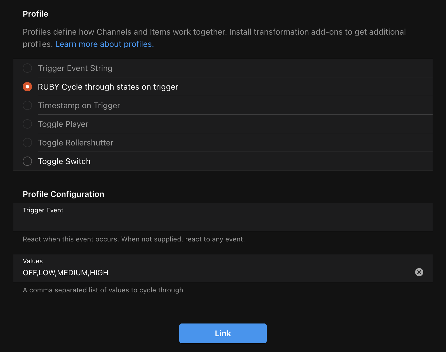

  • Support creating a trigger profile for the UI by @jimtng in #373
    It is now possible (and easy!) to create a profile in JRuby for every possible scenario: State and Trigger profiles, which can be used both in UI and file-based items/links.
    Example code in this post
