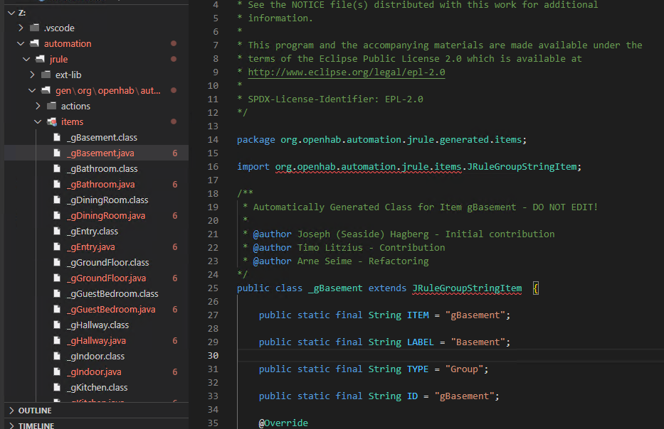

I installed the Beta15 version of JRule and I think I followed most of what I need to do but VSCode is not recognizing jrule.items.
I installed JRule add-on. It built the .java files for each item. I have my OpenHAB config folder shared via Samba. In VSCode I opened the OpenHAB config folder. I have the Microsoft Extension Pack for Java installed and when I open one of the .java files for one of the items I created it doesn’t recognize the import for org.openhab.automation.jrule.items.
I have experience with Java but this is my first time writing Java in VSCode. I’m trying to keep it all in VSCode so I can edit items, things, and all that in the same environment as my rules. If that’s not possible let me know, or if I’m just missing something simple let me know.
Thanks,
Matthew
To me it appears that you have not set the classpath to include the jrule.jar? (automation/jrule/jar/jrule.jar)
Edit: I have not used VSCode with Java
