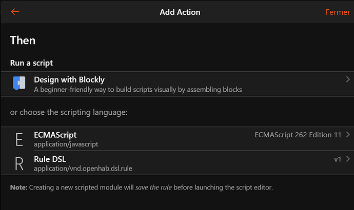

I’m on OH 5.0.2 and I am realizing that my few rules and scripts in JS are in fact written in Nashorn way and executed the Nashorn way while they are identified as “new JS” when I create them, but then, the internal engine behaves as old one…
See what I see:

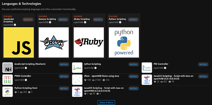

See what I see in the automation section:
It does not seem that I can remove a module to get rid of the old JS module…

This means you do not have Nashorn JS installed at all. So all your rules are running on GrallVM JS. There are differences for sure but for the most part, a Nashorn JS rule will work in GrallVM JS. It’s going to be much longer and more complicated than necessary, but it will work. You’ll eventually probably want to rewrite them to take advantage of the JS Scripting helper library for long term maintainability.
Nashorn provides “ECMAScript 5.1” while GrallVM JS provides “ECMAScript 11” which is what your screenshot shows.
The Blockly code “compiles” to GrallVM JS. So your Blockly codes are running in JS too.

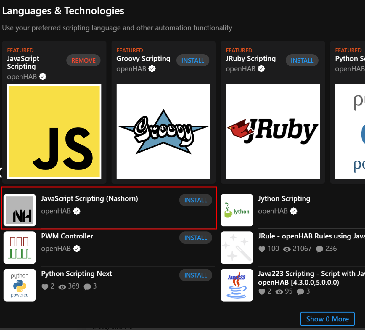

It appears you already have. But in general you just need to uninstall the Nashorn add-on. If you have any rules still using Nashorn JS OH will complain. But, like I said, you appear to have already done this.
And this confirms, Nashorn JS is not installed.
If it says “Install” instead of “Remove” that means it’s not installed.
