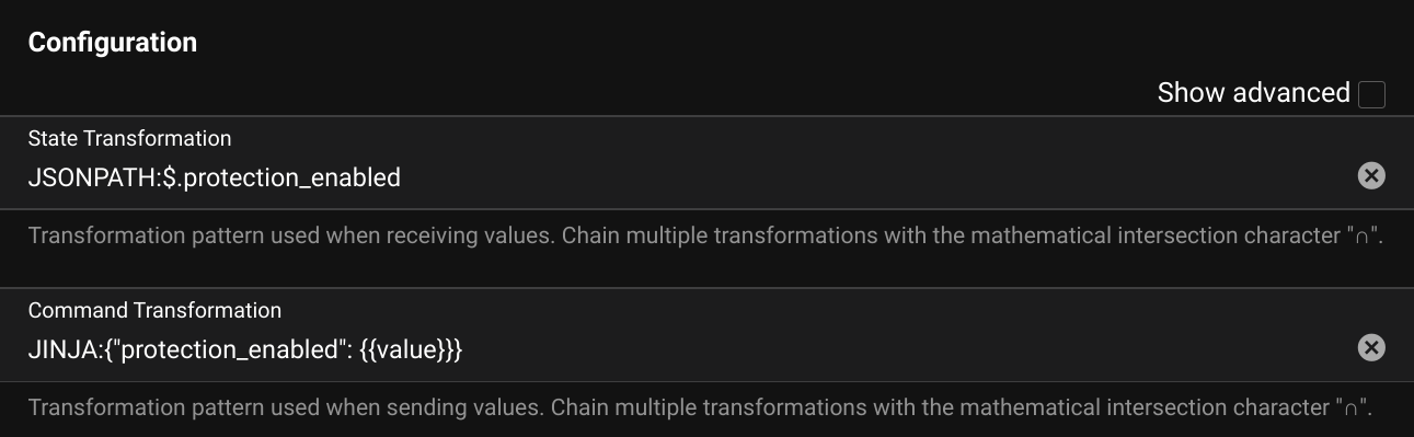

It depends on your keyboard and operating system. It’s in the description in the UI so I usually just copy and paste it from there as I create the Thing in the UI.
It’s the standard math intersection character so it’s part of unicode (U+2229 to be precise).
Since you were not using it before, that isn’t the cause of the warning.
