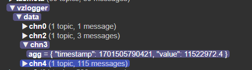

By the way: I’m using volkszähler, too, and I get the raw values via mqtt rather than http. Can be configured in vzlogger.conf, I’m getting one topic per channel, like this:

I also thought about MQTT. I do not have Mosquitto installed yet, but this should not be the issue. My problem is rather that MQTT would send e.g. every 1 minute, but I would only persist every hour at xx:59:30. So there is a possible time gap of max. 1 minute between MQTT value and persisting. Did you solve this issue? At the moment I think it is not possible to persist with a timestamp.
