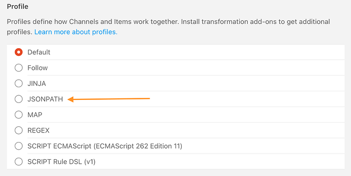

That’s coming from a Profile. So you need to look at the Links between Channels and Items.
The error indicates that you’ve selected a SCRIPT transform profile but supplied a JSONPATH configuration. You need to change to select a JSONPATH.
I couldn’t say why this error is showing up except that perhaps that wasn’t tested before and now it is. It’s always been an error.
Found the error with this piece of advice. Thank you!
