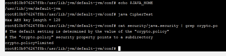

First: What was the output of the Cipher test? Only this will tell if missing encryption strength is the reason for your problem.
Run
java CipherTest.java
