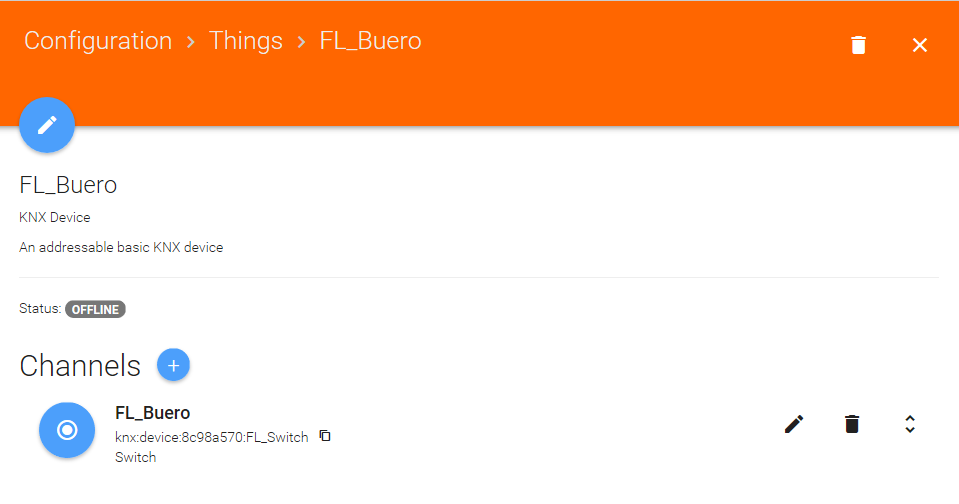

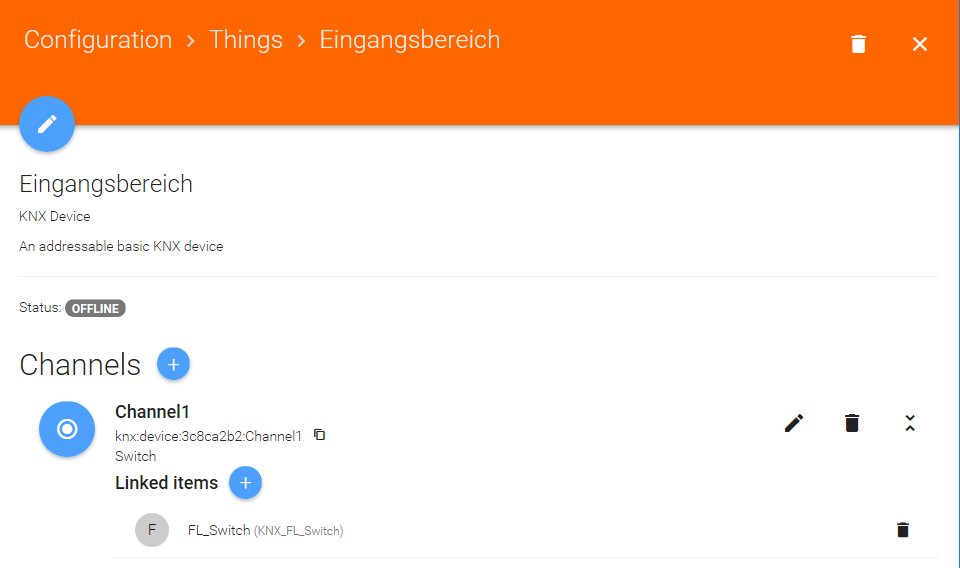

Can you post a screenshot of PaperUI showing the thing and the linked items to its channels? (Expand the channel to show the linked items)
Expand plz (2 arrows image all the way to the right on your screenie)

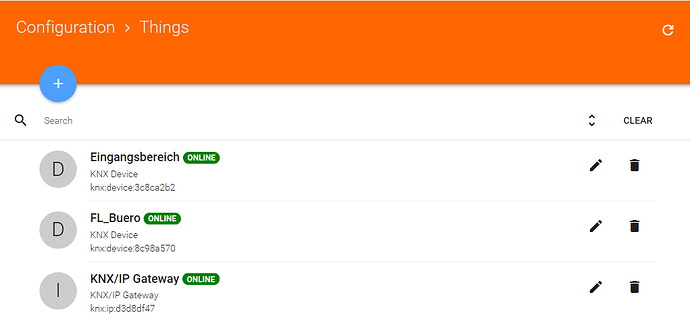

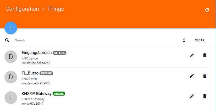

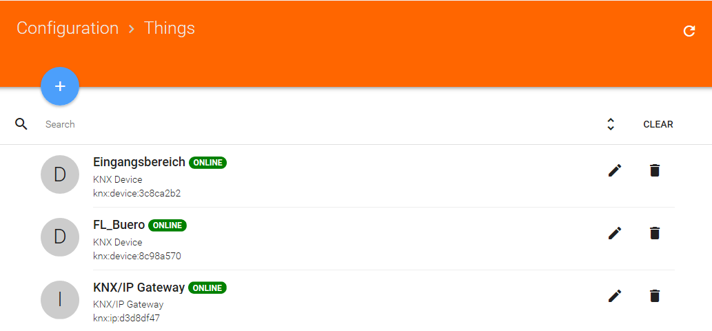

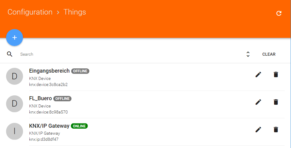

How come the KNX Thing has a Status “Offline” ?
They have always been offline. It is my fourth day I work with OpenHAB. So I am not very experienced. I have an IP KNX Interface with tunneling. This Thing showes online, the Things I have defined “behind” this show offline. I did the binding (channel) between one of the offline KNX Things and the Switch Item in the Paper UI and it worked fine. So my guess was, that OpenHAB cannot “look” behind the IP KNX Interface.
Here how the Things look:

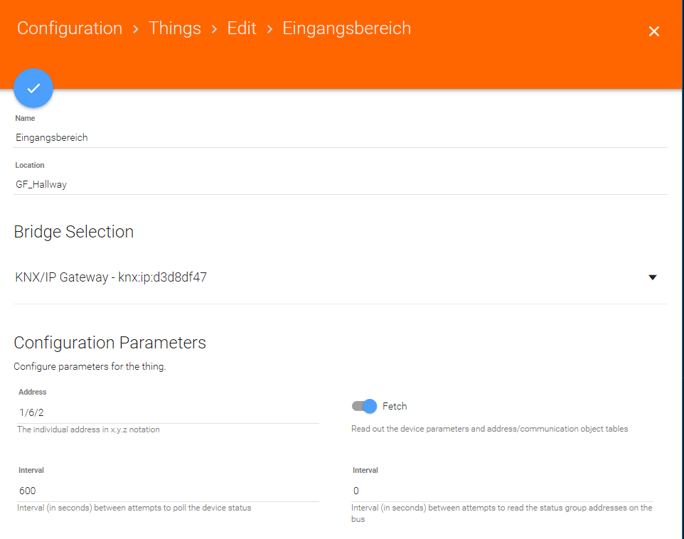

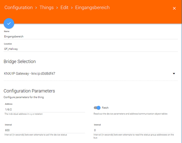

Ok… can you post 3 screenshots please:
  1. One showing the configuration parameters of one of the Offline Things (edit the Thing)
  2. One showing the Channels (expanded with the linked items) of the same Offline Thing as (1) above

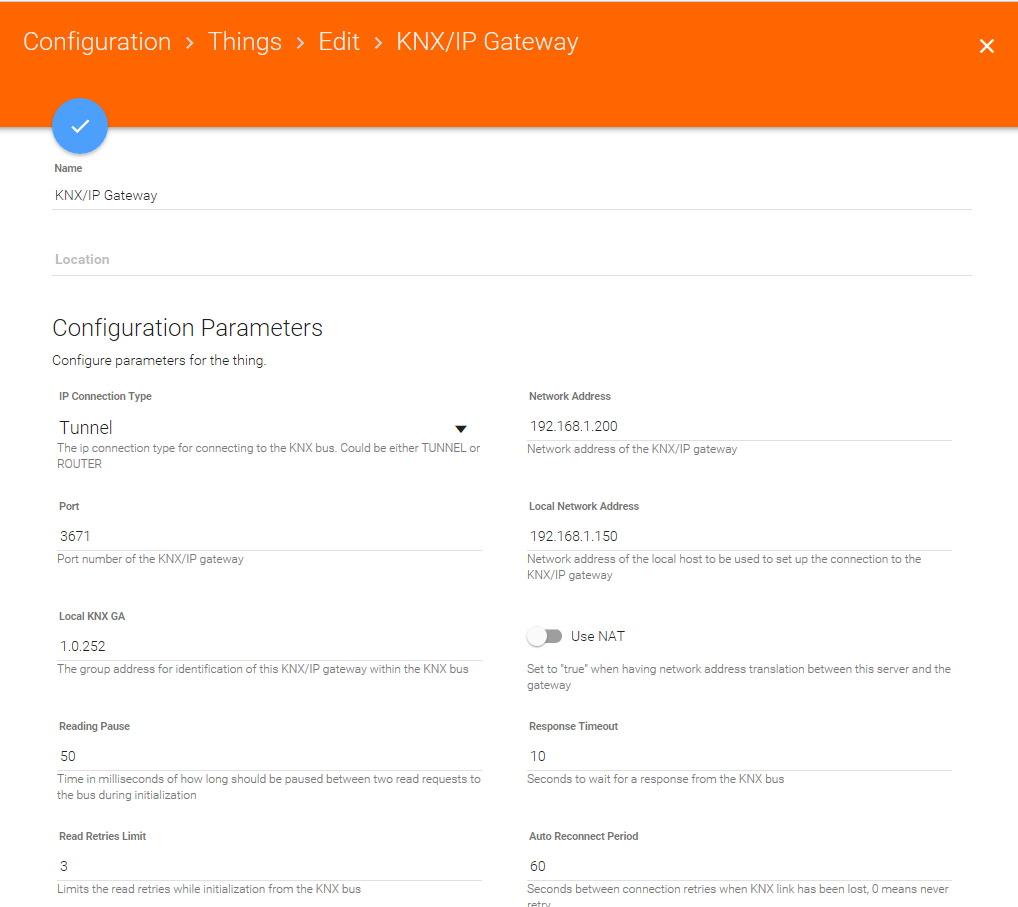

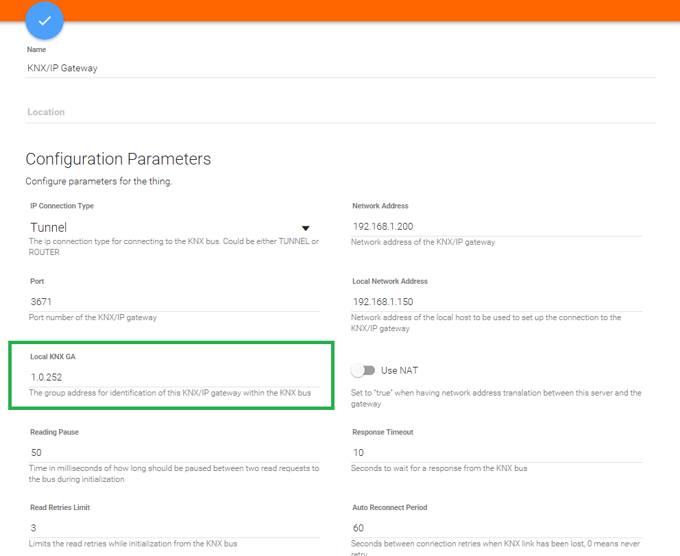

  3. One showing the configuration parameters of the main KNX/IP Gateway
Looks to me that you haven’t selected a Bridge for the (offline) KNX Things… double check this in the configuration

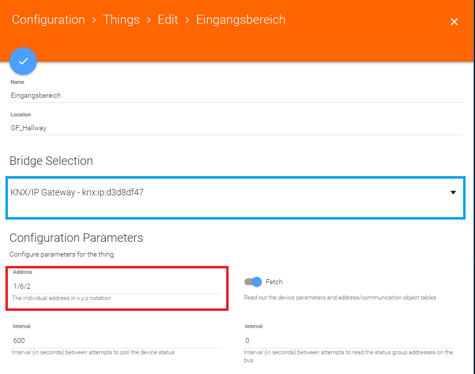

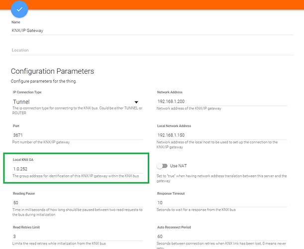

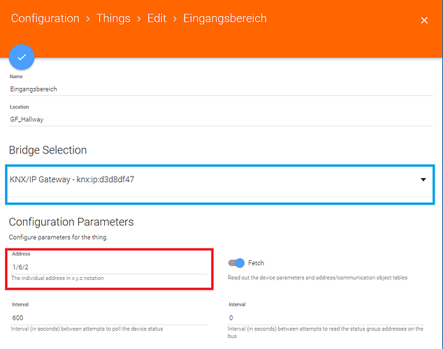

Thx for your help. Here the 3 sreenshots…
change the info in the red box to an IA (Individual Address aka Physical Address) for the KNX Actuator (format of IA: x.y.z (not x/y/z which is for GA)
The Bridge seems to be configured correctly in the Thing (blue box)
@Udo_Hartmann : We have another documentation issue here :slight_smile:
IA instead of GA

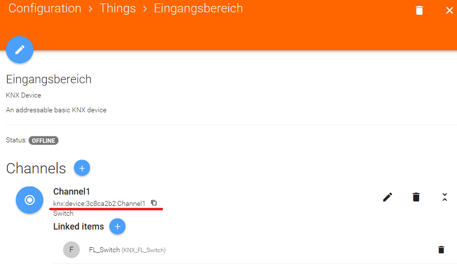

I don’t like how this looks:
It seems to me that it is missing the Bridge info
It should be:
knx:device:d3d8df47:3c8ca2b2:Channel1
maybe it is wrong due to the mis-configured IA…

I understood in the local KNX GA I have to define the KNX GA of the IP KNX Interface which is in my case 1.0.252…

Anyway, I have defined the IA (which is for both Ligths the same DALI Gateway) and they turned to online now.

I have also corrected the KNX/IP Gateway to a GA 1/0/252
I have deleted and newly defined the Thing with IA and the channel. It is now online but the channel information still looks the same?!
