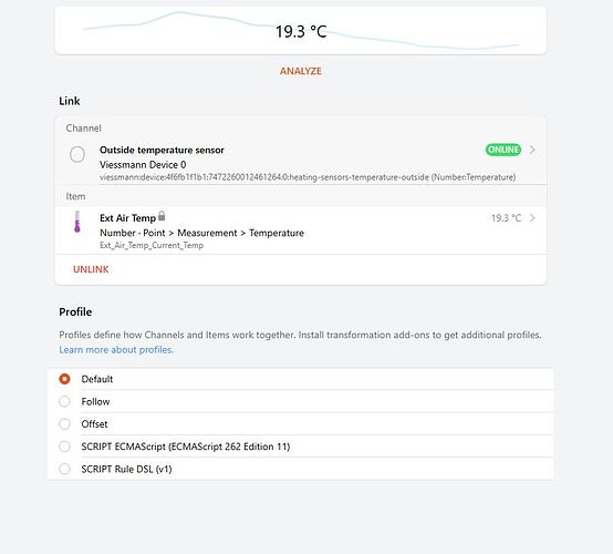

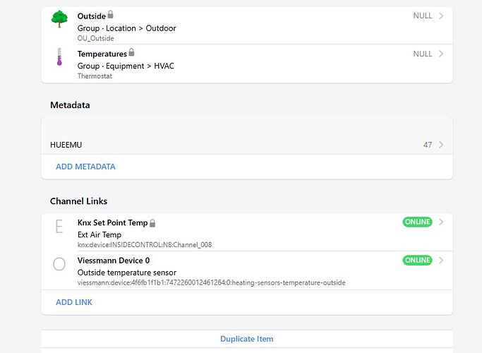

Obviously, you have to link the Items to the new Channels as well (so not only the knx channel but also the viessmann channel)
Oh ok, its thats simple then. When linking the channels, as you can see, I have linked them via the Main UI. Can this done with text files, for the viessmann channel. I saw a post from you discussing with the creator of the viessmann 3rd party binding, that you were use to using text based configs, and why the binding couldnt be set up using text based files?
Of course you can link as many channels to as many items as you want, no matter if using Main UI or Text files, but it’s definitely better to use only one configuration option, so either text or Main UI.

And each of these items can be linked in parallel to another channel as well, like that:
Number:Temperature   HeatSensorsTemperatureOutside "Outside Temperatur Sensor" (gHeizung) ["Measurement"] {channel="viessmann:device:bridge:vitoconnect:heizung:heating-sensors-temperature-outside", channel="knx:device:INSIDECONTROL:N8:Channel_008", unit="°C", stateDescription=""[pattern="%.1f °C"]}
given that your knx bridge is knx:<ip or serial>:INSIDECONTROL
Thank you very much, very helpful indeed, you are a STAR!
