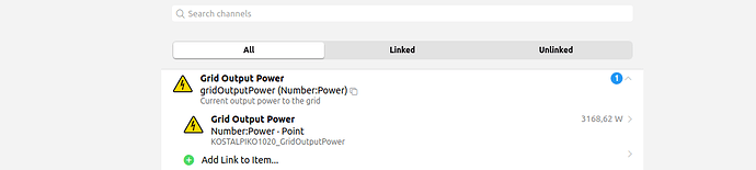

now I can see all 3 groups of dxsEntries Requested and Responsed correctly from the inverter.
What is the state of the Thing Kostal PIKO 10-20 and can you see any values in the Items, during this kind of capture.

just made and uploaded a very ‘ugly’ version, but Please give it a try and capture as before, Please also check status of Thing and Items. The Channel Grid Output Power should have a value like 0W if the Thing goes ONLINE.
Please, also have a look at events.log.
With the “ugly” version, the items did not change. The Thing is Online in the GUI.

Now I removed the items and also the test binding. Reinstalled the binding from the “store” and configured some items in the GUI.
But the behavior is still the same: The items have no data and there is still the error in the events.log
