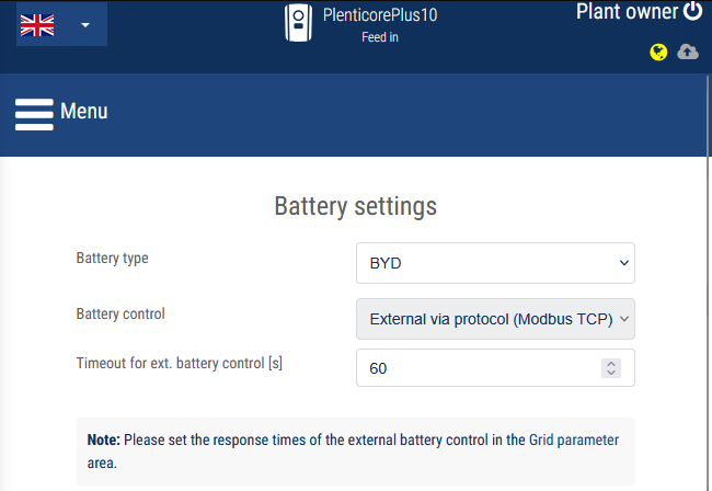

Two things:
  1. Sync of timeout
    As you can see, the timeout set here is 60secs (Don’t know the default tbh).
    if you are not “in-sync” with that timeout, that could be one reason.
  2. “Discharge Limit” is Register 1040, which is only a “limit” (you tell the inverter it could only discharge until 2000W) and not the actual (dis-)charge power. for that you have to use Register 1034, which is the absolute DC Charge Power (Negative values will charge the battery, positive values will discharge the battery)
