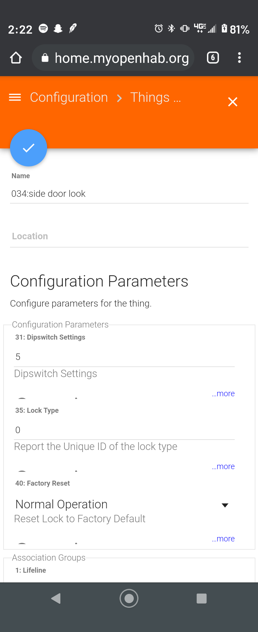

I preformed a manual reset after I excluded it, would it make a difference if I reset it via the device settings in paperUI?
You need to factory reset the device using the instructions from its manual. It cannot be done externally.
I reset it through paperUI
Then excluded it then did a manual factory reset twice then included it but I still have the same problem

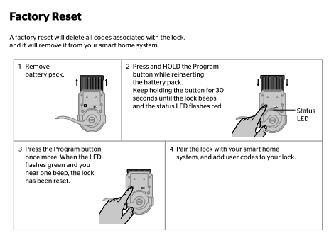

You cannot factory reset the device through the Paper UI. According to the manual in our database this is how you perform a factory reset.
I did that as well
