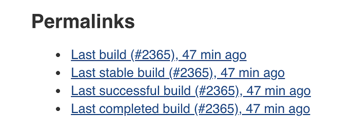

No - it needs to be reviewed and merged by a maintainer (normally me for ZWave stuff). If code changes were merged automatically, there would be nothing to stop people making a complete mess of the system.
It’s not been built yet.
