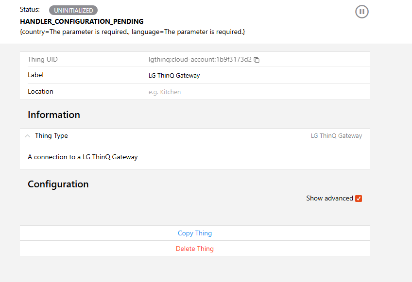

I updated openhab from 4.3.3 to 4.3.7-1 today, hoping that I could get the LGthing binding to run again, which didnt work with 4.3.3 but used to work some time ago.
But it seems like I still have issues.I cant get the bridgde to connect. The return error is:
Error getting devices from LG API in scanner process.
Any idea what to do?
Both my dryer and my washingmachine is working fine in the LGthing app.

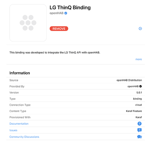

I just updated from openhab 4.3.6 to 5.0.2. Like always, even if I had installed the binding from market place, It didn’t reinstalled the binding. I removed my current gateway thing and installed the new official binding. I went and add the the gateway thing and it doesn’t work. There’s no option to say anything like user account and such:
edit: Ok, I don’t know why but I add to restart the server to see the proper screen.
If I may add, can you add Canada (CA) in the country list? Right now, I put Other and CA which solved the unable to connect. Thanks!

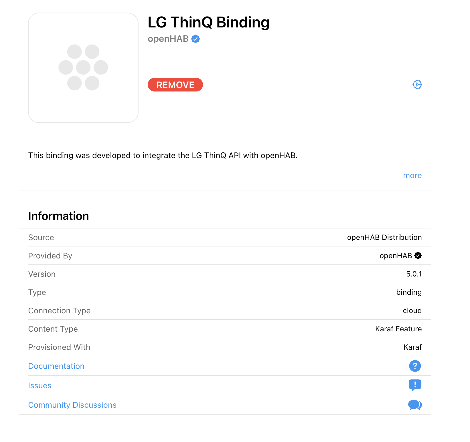

I noticed the same, if I clean cache now the LG ThinQ binding does not re-install and I have to do it manually. To be clear I’m using the marketplace version of the binding.
This is the only binding that I use that seems to require this.
I don’t believe this behavior is related to the binding itself. The thing/bridge configuration UI is managed by openHAB and driven by the XML configuration descriptors - not by the binding logic.
One important note: between openHAB 4.3 and 5.x several configuration property names were changed as part of the requirements for this binding to become an official openHAB addon. These changes may affect how previously stored metadata is interpreted, and could explain any configuration inconsistencies after upgrading.
BTW I suggest you, if you are in the 5.X version, to install the official release available in AddsOn session.
Yeah I recreated everything from scratch when I switched to the new one. The weird thing is only because the gateway had no field. Reboot fixed it at least.
