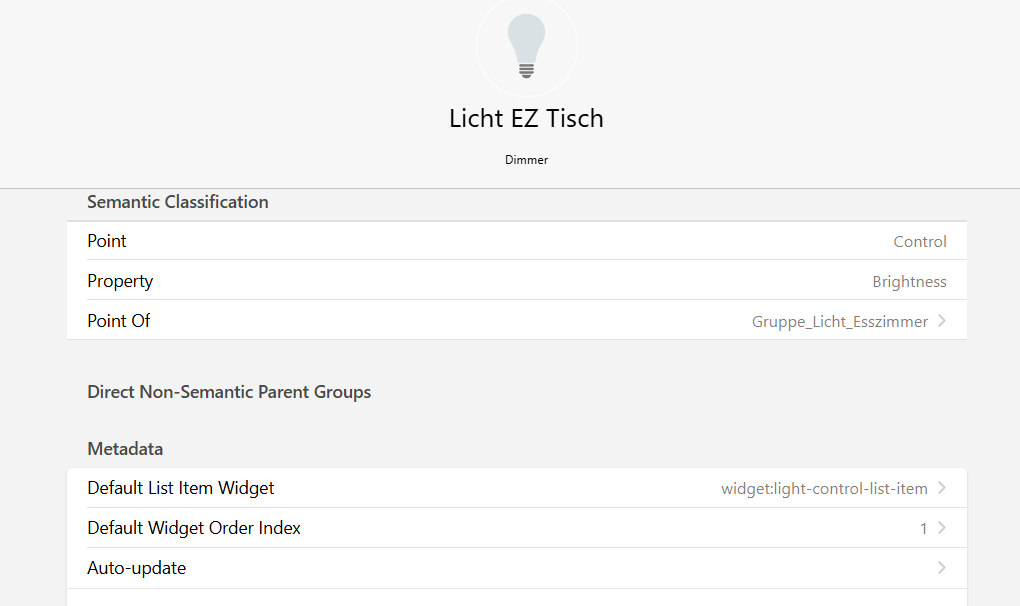

I really like this widget and would love to use it.
Unfortunately, it’s not working for some reason. I’m using openHAB 5.0.1.
It looks like so:
My item’s metadata looks like this.
What could be the problem?

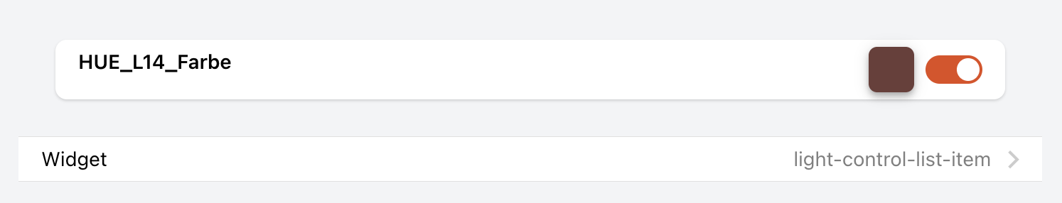

Hi Florian, I was trying your control widget with the latest openHAB 5.2.0.M5 and applied it to a Color item. Item is placed to a location. It shows up under the Property tab of the location card, but does only shows the color picker and the switch, but there is no “triangle” to expand the accordion.
It looks the same as with the default supplied widget. Any thoughts? More information required to debug? Could it be, that the UI does not pickup the new “Default List Item Widget”?
Thanks,
Michael
Update: I have modified some text in the custom default widget. This gets displayed in the location card as expected → UI picks up “new” default list widget,
I have also tried a b/w lamp with brightness channel → same results: widget shows switch but no way to expand into the slider. However, Color selection is invisible.
              visible: "=items[props.item].type === 'HSB' ? true : false"
works as expected.
I have tested IOS (Mac, iWatch) and Win11 with Edge.
All the same result: no way to expand the widget to the accordion slider - missing “triangle”
Hmmm… Is there s special requirement on the item?
