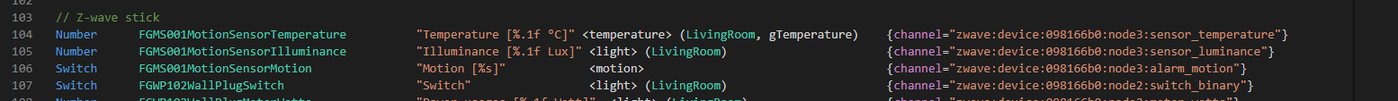

I have a fibaro wall plug to turn on and off the light. I have configred the z-wave binding (created by Chris Jackson) and have created the item (switch) in the item file. (Row 107)
This item is also displayed in the openhab app. When I toggle the switch, the light is going on. So this is workfing great. But the issue is now: if i toggel this switch via a rule in node red, the switch went from off to on, but the light is still off.
I am using the “openhab2-out node” to toggel the switch.
