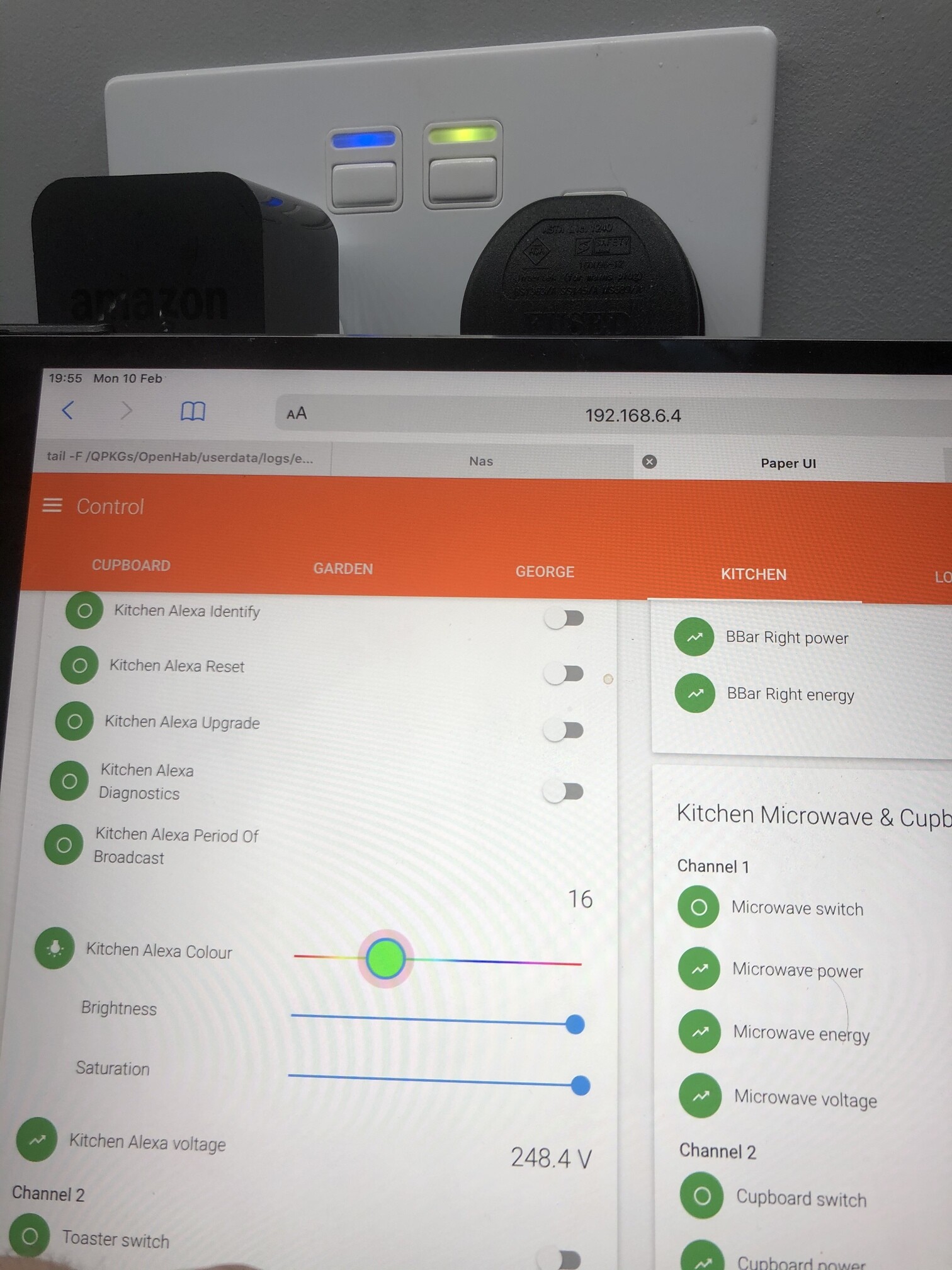

Are you testing that with a socket?
Yes, gen2 double
Do you see both dimmers?
I’ll try adding my socket later then and see if it works for me too
Didn’t upload video :weary_face:
It’s defo working, just restricted
Oh and you can see my period of broadcast in the photo - 16.. don’t know what it refers to, been on longer than 16 days, off within 16 weeks.. god knows

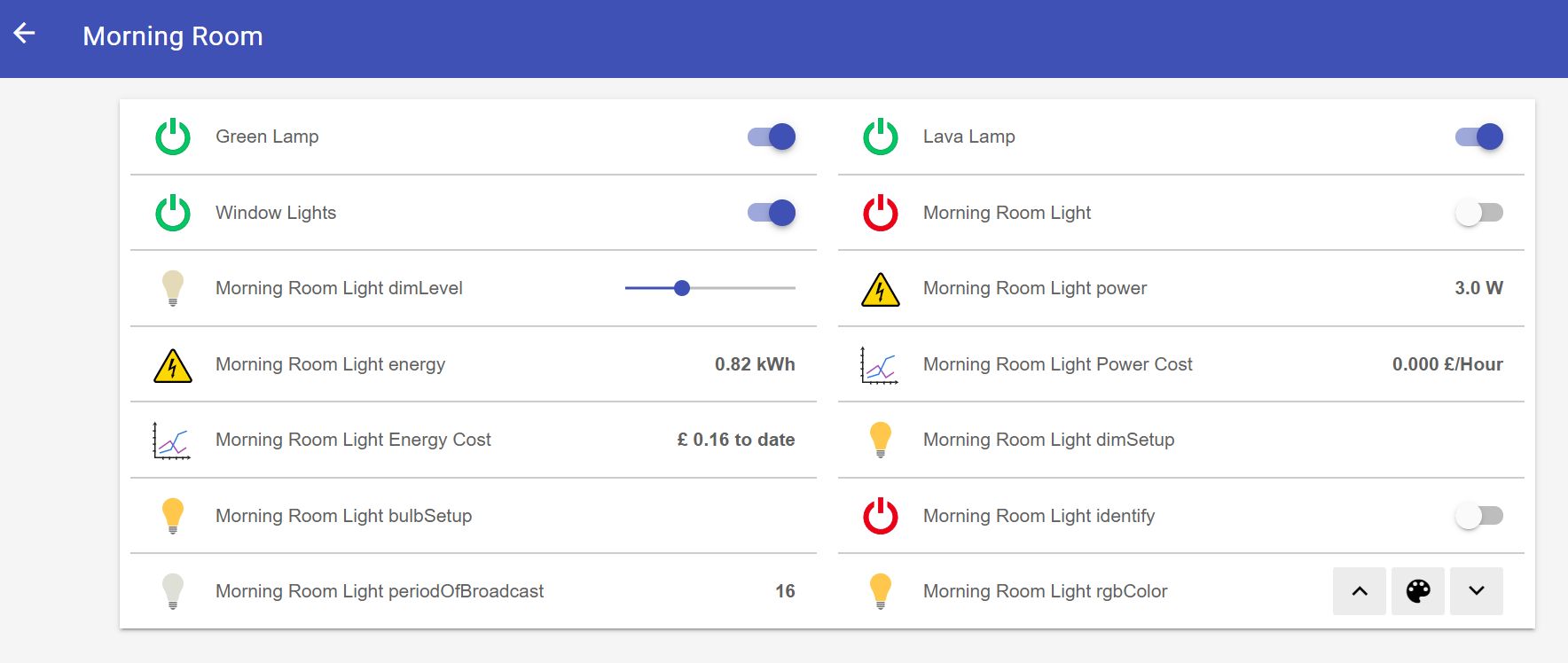

@xela 2 gang dimmer is working both ways for me.

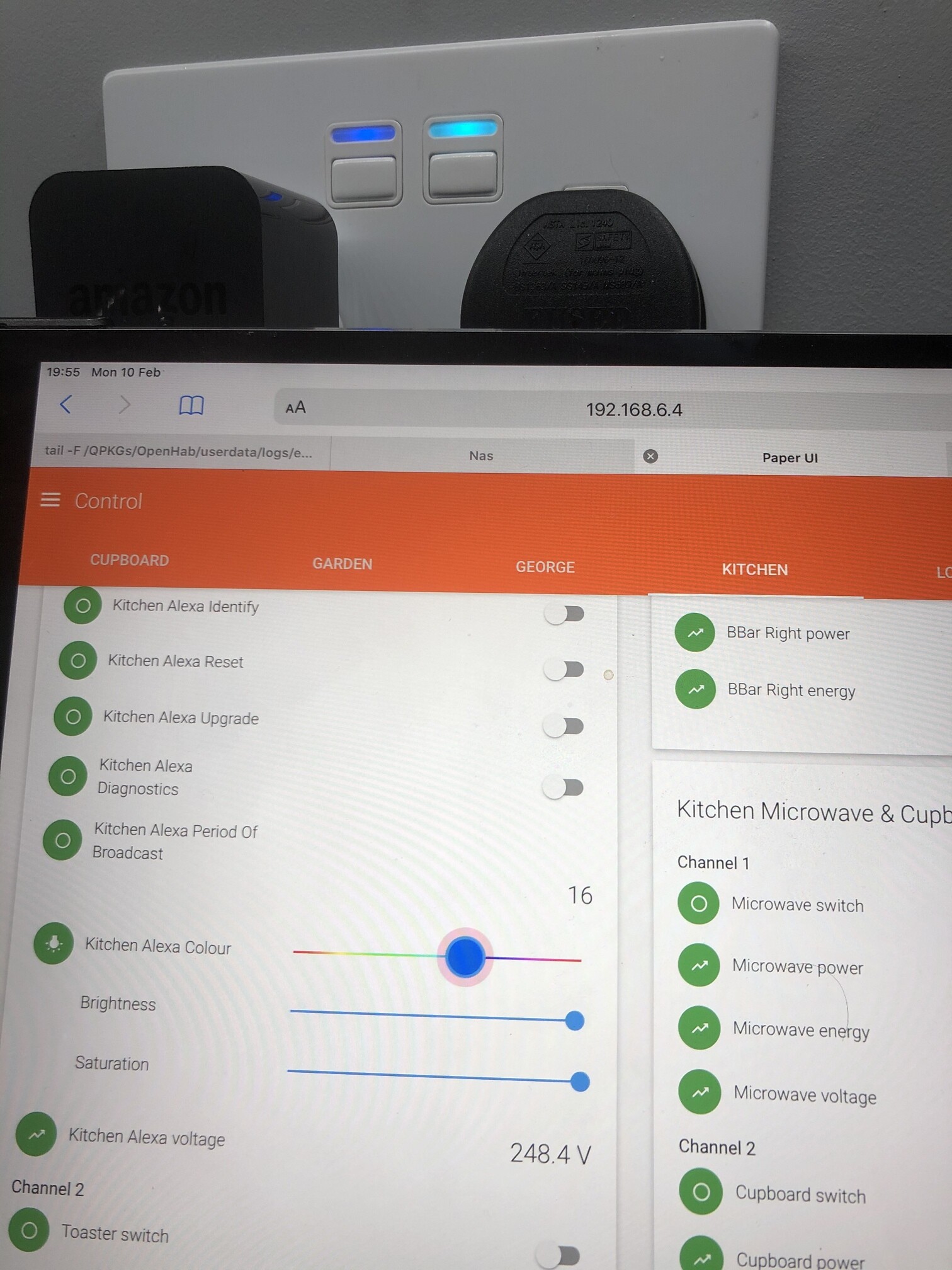

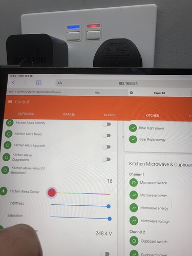

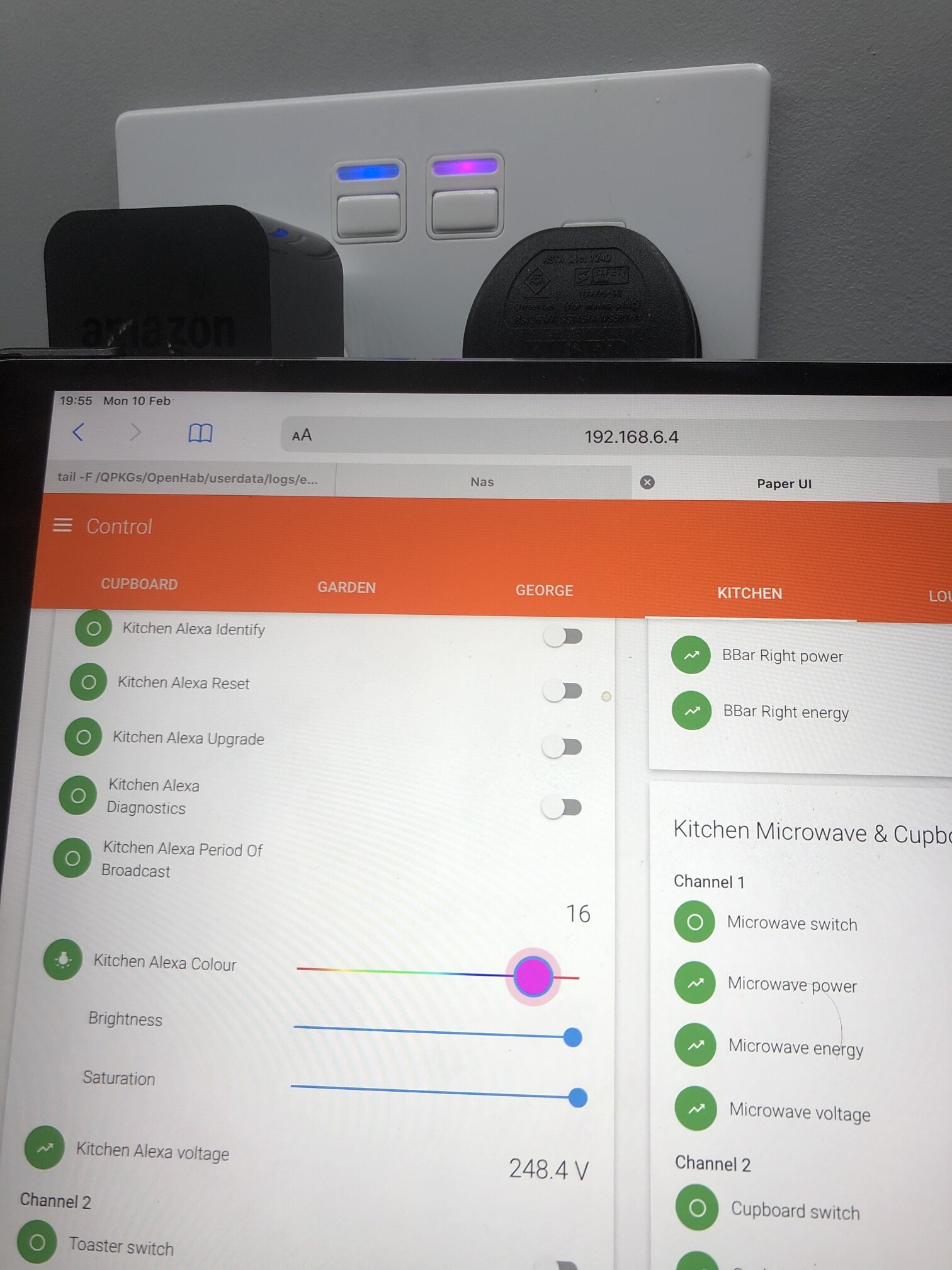

@delid4ve Ah, you’re doing it via Control under Paper UI - I’m doing it via Sitemap where it looks very different
Yeah I did do on habpanel with the modal picker, kinda worked but was a bit more finicky
To the centre goes brighter but then to white, to the outer dims it.
Does work though
Tricky to get red on the Color wheel but easier to dim
Hsl sliders on habpanel seem to be the best option - you could set up a dummy choice item to send specific values to the channel
I’ll have a little play with the channel,
Saturation has to be at 1.0 for a Color to display (otherwise white led)
Luminance can only go between 0 & 0.5, anymore it changes to white led (0 turns it off completely)
Hue: Red only works at 0, not at 360
Purple: 240 - 360
Cyan: 121 - 239
Green: 120 only
Yellow: 1 - 119
Red - 0
White: (saturation below 1.0)
