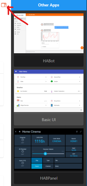

There should be. On the home page look for that button and it will open the “other apps” drawer.
The tiles displayed there are the equivalent of those of the former dashboard, so the external links should be there as well. If that’s not the case, maybe there’s a problem - open an issue in https://github.com/openhab/openhab-core/issues to have it looked at.
Thank you Yannick, I see “Basic UI” and “HABPanel” there,
but not the links that are defined in the /etc/openhab/services/dashboard.cfg file.
That’s where the links to Grafana and FrontTail are.
