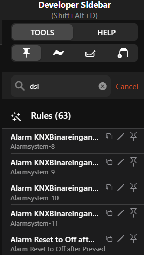

Well, let me answer that first part my self :wink:
Development sidebar:
Openhab’s REST API ip-address/rest/rules gives you a json object with all rules where you can access the type of language by actions.configuration.type (gives you “application/javascript”)
