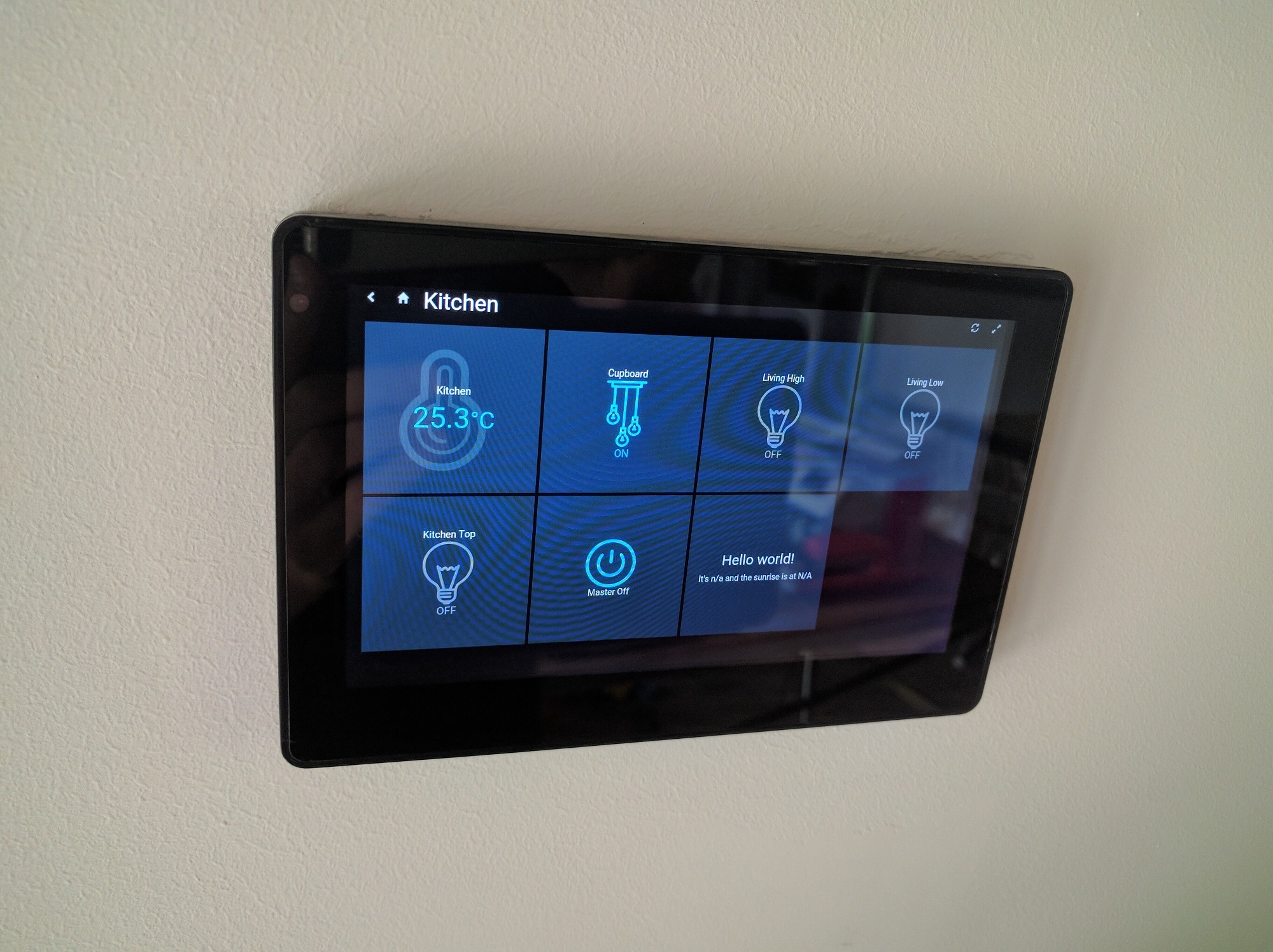

IMHO the orginal size of the elements is too small for my application. I do test the Smart Home UI on my wife and mother in law and in order for to be usable by anyone. The 4x2 grid with large descriptive text is max what a 70years old can handle.
As you can see with habpanel it does not look great yet. Font is to small and notification that the light is on is not pronouced enought.

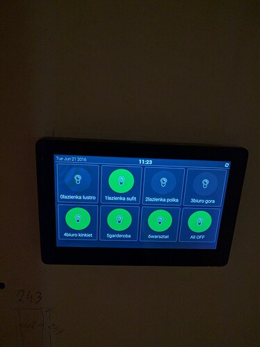

Here for comparision is my old interface based on the “home automation for geeks” tutorial that looked better, but was only limited to switches and sensors. I will try to recreate that in HABpanel

Ok so after 3 days I’m almost there using templates instead of buttons and switches.
Those are very rough hacks to get the buttons readable from a distance. And they are now consistent with labels below for both buttons and switches.
