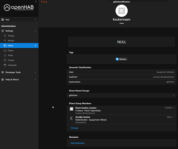

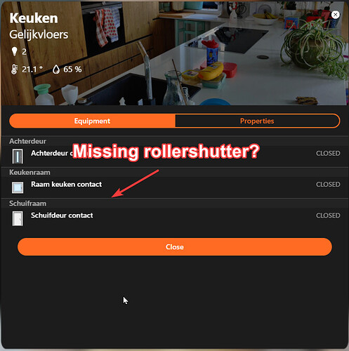

My kitchen has a window and that window has a rollershutter and a open/close sensor. So I defined the window to be an equipment with as location “kitchen”. Then defined the sensor as a point Openstate and the rollershutter as an equipment that is part of the window:
I’ve been playing around with the settings and I could of course mark the rollershutter as a point of type ‘Control’ and then it does appear. But then it would not appear in the equipment card “Blinds and rollershutters”. I could also add the location group directly to the sub equipment but then the rollershutters appears in the locations card as a separate equipment.

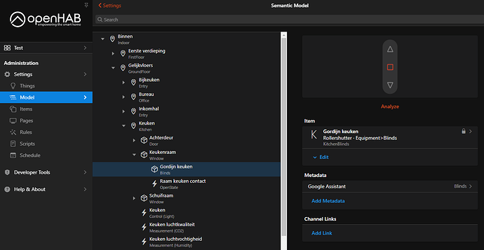

First reload the page to make sure changes made are being picked up. Next, according to the screen shot of your model “Gordjin keuken” has no semantically tagged members. I can see that because there is no little triangle next to it to open it up to see it’s members. So either your rollershutter is not properly tagged with a Point tag, or it’s not a member of the equipment Group.
The cards on the Overview tabs will not show equipment that do not have any Points.

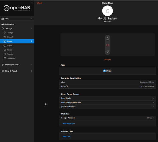

Thank you Rich for your very fast response! In my example above, my rollershutter item is directly tagged as the Equipment of type “Blinds”. So it has no need for points and thus would not show up in the overview tabs as you mention (I wasn’t aware of that filter).
I have added an extra equipment group “Gordijn” in between the rollershutter item and the Window equipment:
But it still doesn’t show up in the overview card.
I come from the time that Openhab was mainly controlled with files so I have my semantics also in files. (I have way to many things/items to transform everything into GUI based control :().
The relevant lines:
// Equipments:
Group gKitchen "Keuken" <kitchen> (gGroundFloor) ["Kitchen"]
Group gKitchenWindow "Keukenraam" <window> (gKitchen) ["Window"]
Group gKitchenWindowBlinds "Gordijn" <blinds> (gKitchenWindow) ["Blinds"]
// The point:
Rollershutter KitchenBlinds "Gordijn keuken" (InnerBlinds, InnerBlindsGroundFloor, gKitchenWindowBlinds) ["Control", "Opening"] { ga="Blinds" }
This could be part of the problem. There is no event generated when you modify an Item’s tags and Group membership. Are you reloading the whole webpage every time you modify the .items file?

All I can offer now is to file an issue. I don’t know why it’s not showing, unless somehow you’ve managed to use tags that are not supported.
The main focus is on the badges but at the end of the descriptions it’s clear that the sub equipments are also not shown for the topic starter. I’ll add my last example to that issue to clarify as well.

As for the bug that this topic is about, I think I’m going to mark the rollershutter as a Control point for the window. I will not have a list of equipments of type “Blinds” but so be it.
