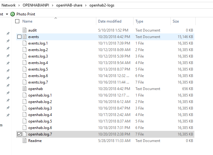

Then I opened openhab2-logs (RaspbberyPi/OH2) via network from my PC and the directory has these files (I did not understand what exactly to do now):
Not sure why you have multiple openhab.logs? Do you have another SD card?
Nope… one only.
Looking at this your SD card may be failing. You can do a fresh image install and restore the backup or try deleting a few files and see if openhabian-config will install the log viewer.
