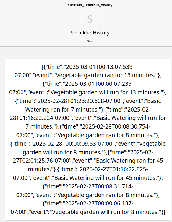

I use this exact approach to track some recent history of my sprinkler system. My system sends brief text descriptions of its events, but the channel for this is only the current event, so I have a second item that collects the information.
My item is string item:
The rule is fairly straightforward. When the sprinkler event item linked to the channel changes this rule fires:
var tStamp = time.ZonedDateTime.now();
var timeForm = time.DateTimeFormatter.ISO_OFFSET_DATE_TIME;
historyItem = items.getItem('Sprinkler_TimerBox_History');
historyState = historyItem.state
history = JSON.parse(historyState);
history.unshift({"time": `${tStamp.format(timeForm)}`,"event": `${items.getItem('Sprinkler_TimerBox_ScheduleInfo').state}`});
while (history.length > 10) history.pop();
historyItem.sendCommand(JSON.stringify(history));
It gets the current list string and parses that back into an array. It adds the newest event (and a timestamp) to the 0 position of the array shifting all previous events down. Then if there are more than 10 events in the list it removes the oldest one before turning the array back into a string to be stored in the item again.
Then, a simple repeater which parses that JSON string:
- component: oh-repeater
    for: event
    in: =JSON.parse(items.Sprinkler_TimerBox_History.state)
    sourceType: array
    default:
      - component: oh-list-item
          after: =loop.event.event
          title: =dayjs(loop.event.time).fromNow()
leads to a list in my sprinkler widget with that log history:

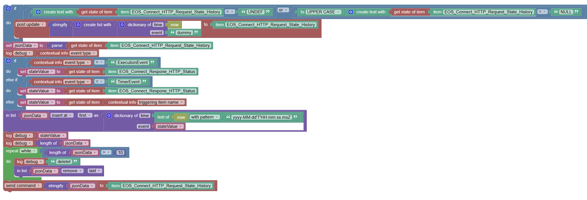

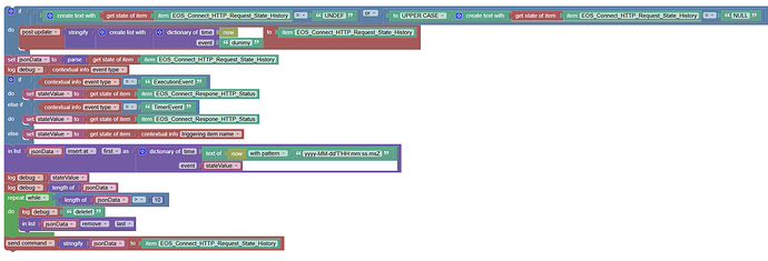

The log book functionality from @JustinG is a great idea. However, I had the problem that I didn’t know how to initialize the histoy item and therefore couldn’t get the rule to work at first. Here is my suggestion for an extension in Blockly and in JavaScript.
var jsonData, stateValue;
if (String(items.getItem('EOS_Connect_HTTP_Request_State_History').state) == 'UNDEF' || String(items.getItem('EOS_Connect_HTTP_Request_State_History').state).toUpperCase() == 'NULL') {
  items.getItem('EOS_Connect_HTTP_Request_State_History').postUpdate((JSON.stringify([{'time': time.ZonedDateTime.now(), 'event': 'dummy'}])
jsonData = (JSON.parse(items.getItem('EOS_Connect_HTTP_Request_State_History').state)
console.debug(event.type);
if (event.type == 'ExecutionEvent') {
  stateValue = items.getItem('EOS_Connect_Respone_HTTP_Status').state;
} else if (event.type == 'TimerEvent') {
} else {
  stateValue = items.getItem(event.itemName).state;
jsonData.unshift({'time': (time.ZonedDateTime.now()).format(time.DateTimeFormatter.ofPattern('yyyy-MM-dd\'T\'HH:mm:ss.msZ')), 'event': stateValue});
console.debug(stateValue);
console.debug((jsonData.length));
while (jsonData.length > 10) {
  console.debug('deletet');
  jsonData.pop();
items.getItem('EOS_Connect_HTTP_Request_State_History').sendCommand((JSON.stringify(jsonData)
