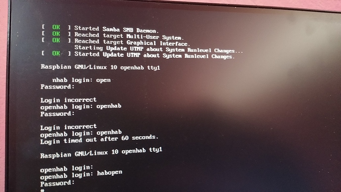

- Issue of the topic: please be detailed explaining your issue first run, login openhab / habopen failt

Did you by any chance use the openhabian image?
Where do you try to login? Those credentials are for the Karaf console, you would need to login to the OS before that. On an openhabian installation such login would need openhabian/openhabian. Read Here
Openhabian/openhabian worked

The openhabian image takes sometime in order to install everything. How long did you wait?
Found my mistake!
Not choose raspberry at the download site!
