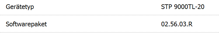

Which firmware version does your inverter has?
Mine:

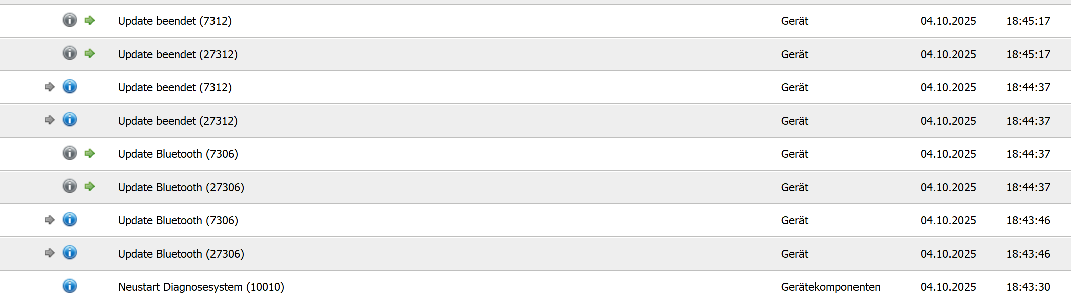

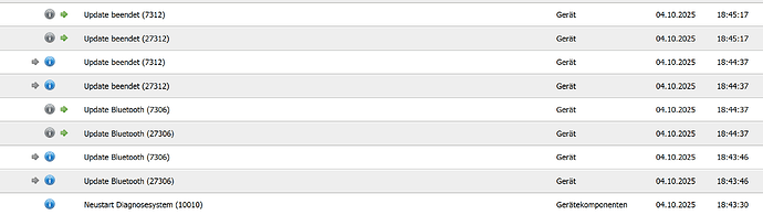

The inverter logs show some update entries …
Maybe SMA “killed” modbus module?
My firmware is different. 3.6.18.R
different inverter..

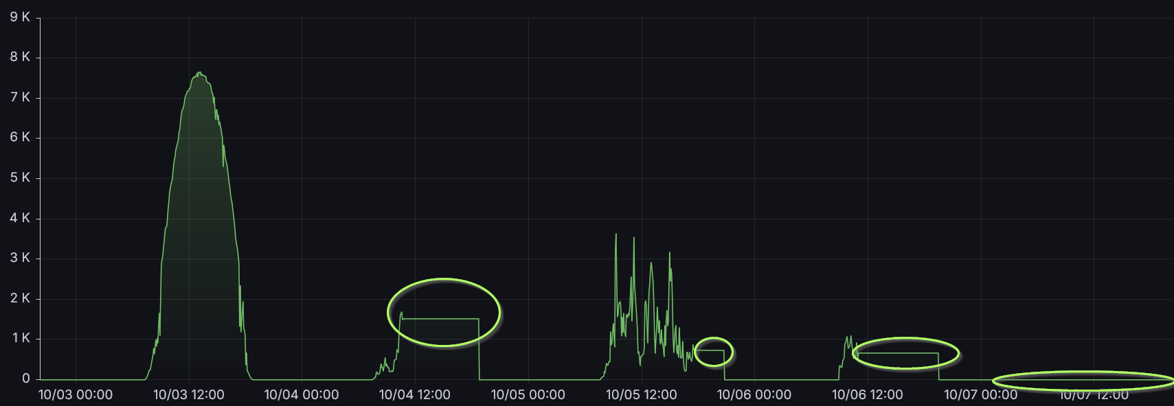

My grafana graph is showing the problems quite good:
This looks weird..
Ethernet or wifi? Maybe here a bad connection?
