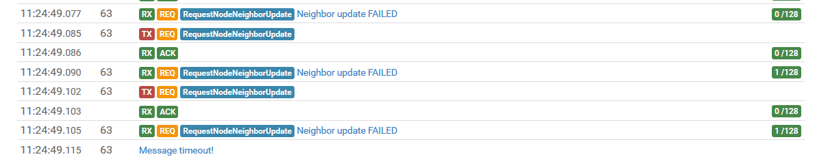

I am seeing some timeouts and things going offline after your nightly heal, it might be worth a try to disable nightly heal if you don’t plan to move your devices:
Commands are rejected from the controller for different nodes:
Neighbor updates are failing:

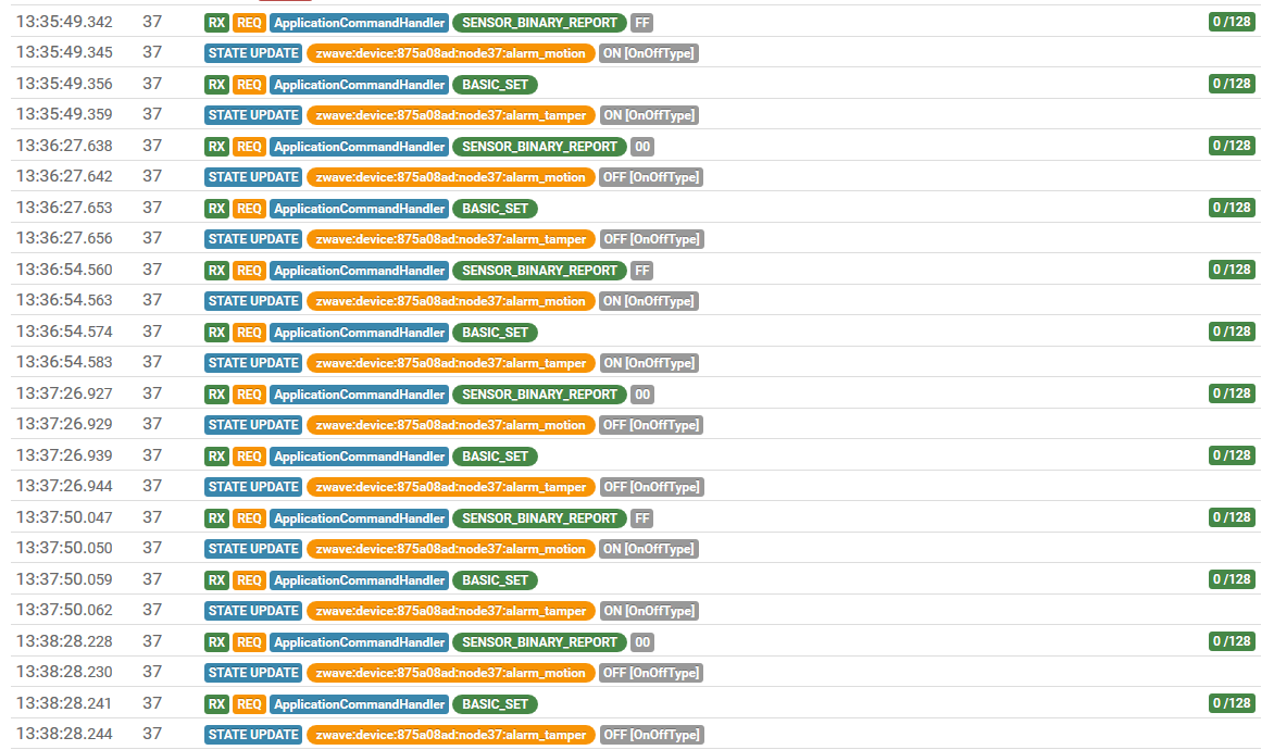

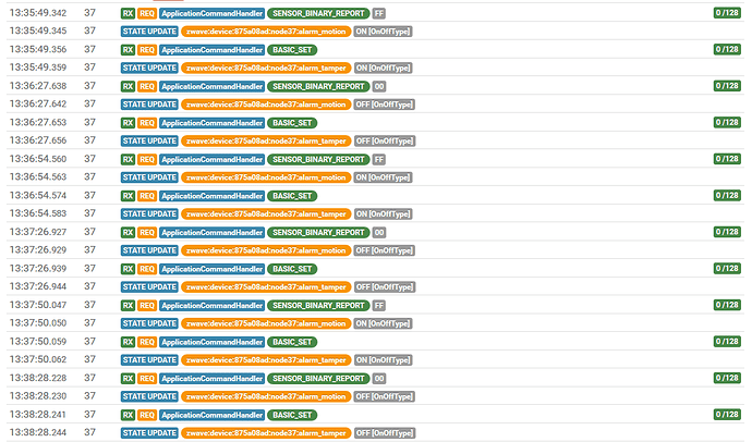

State updates are sent multiple times for different devices, are you sure you have the association groups set correctly (only one (the correct) group to your controller, not several groups, this can cause issues):

Yes, I’ve seen this in the logs, but the main question why has it started to happen after upgrade? Everything was ok before, and I didn’t perform any hardware changes (except adding new Popp Mold sensor, discussed in another thread).
27, 56, 63 are all Wired devices and not so far from the controller.

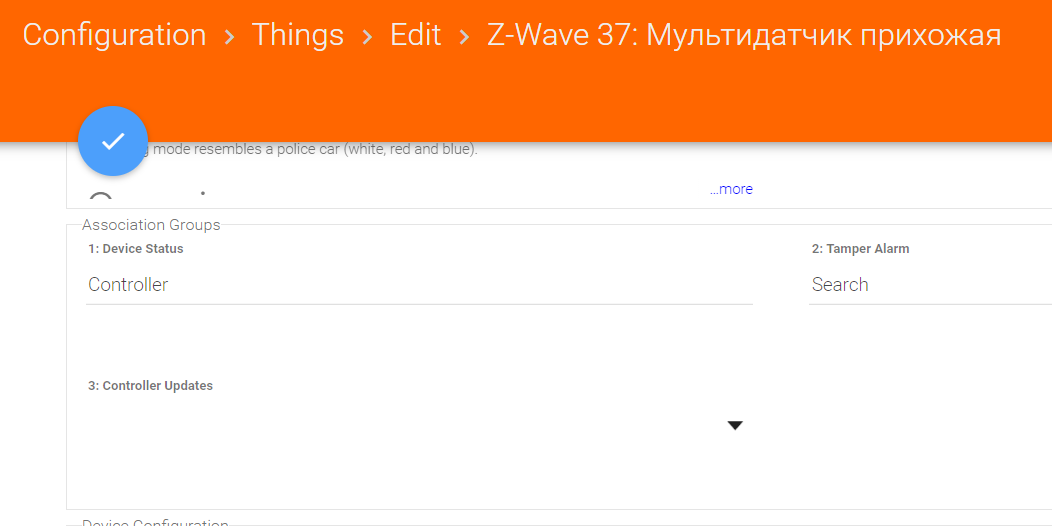

No, device 37 has only one association with the controller - device status group:
Maybe this is because this is a multichannel device (Fibaro multisensor), and updates are coming from different sensors?

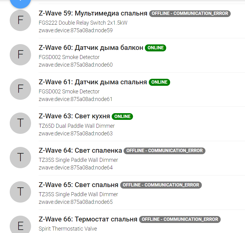

BTW, again, part of my wired devices are gone offline (sorry for russian device names on the screenshot):

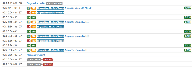

Now all my wired devices have gave offline. But they are “working” - receiving commands and sending status updates.
And all of them are stuck on the NodeNeighborUpdate failed, and due to this they cannot complete initial initialization after binding restart, so looks like healing isn’t the cause (I’ve recalled one detail - I’ve tried to heal one of wired devices manually via Habmin, and the log told me smth like “healing cancelled because initialization is not completed”).
I’ve also seen NodeNeighborUpdate failed for battery devices, but they are not going offline after that.
I start thinking that this NodeNeighborUpdate request has failed for literally all devices in my network.
