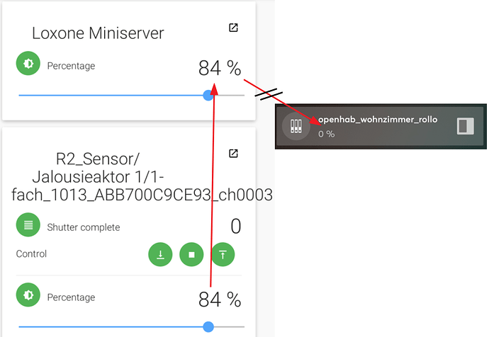

I am using the free@home binding to include my blinds.
Now i want to send the position (percentage value) from Openhab to Loxone.
The item within openhab shows the actual value, but the item within Loxone does not update it´s value.
What am i doing wrong?

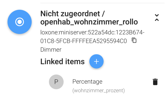

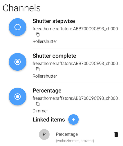

this is the item for the blind from the free@home binding
and this is the item link for loxone
So you have two bindings on one item wohnzieemr_prozent
I think there may be a conflict here and you may need a rule

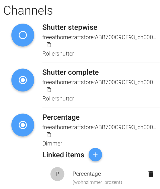

i tried like you said.
now i have a item linked to free@home (wohnzimmer_prozent)
and one item linked to loxone (wohnzimmer_prozent_loxone).
if i now change the value by hand for wohnzimmer_prozent_loxone within the gui of openhab, the value changes within the loxone gui.
this is great.
but the rule is not working.
