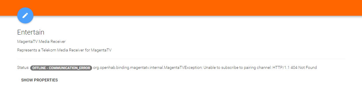

i got the following problem after installing the binding from PaperUI (Restart did not help).
After entering AccountName (xxx.xxx@t-online.de) and AccountPassword in PaperUI a UserID is retrieved. But in the end I got the ā€œOffline - Communication Errorā€.
Do you have a clue?

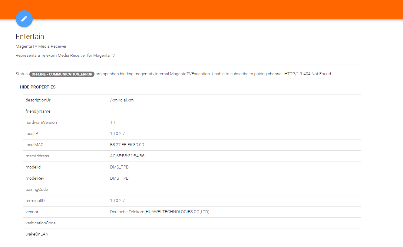

please turn logging into TRACE, I need to see the URLs and provide a screenshot of the thing properties

2020-10-12 18:36:07.390 [DEBUG] [tv.internal.handler.MagentaTVHandler] - Entertain: Thing config updated, re-initialize
2020-10-12 18:36:07.404 [TRACE] [tatv.internal.MagentaTVDeviceManager] - Lookup device, uniqueId=25AB8D5EAF6F1701AD8E81DCC93D048E
2020-10-12 18:36:07.408 [TRACE] [tatv.internal.MagentaTVDeviceManager] - Devies[0]: deviceId=25AB8D5EAF6F1701AD8E81DCC93D048E, UDN=BB5E21CE-2222-11B2-F918-AC6FBB31B4B6, ipAddress=10.0.2.20, macAddress=AC6FBB31B4B6
2020-10-12 18:36:07.413 [TRACE] [tatv.internal.MagentaTVDeviceManager] - Device with UDN BB5E21CE-2222-11B2-F918-AC6FBB31B4B6 removed from table, new site=1
2020-10-12 18:36:12.442 [DEBUG] [tv.internal.handler.MagentaTVHandler] - Entertain: Login with account xxx@t-online.de
2020-10-12 18:36:12.448 [DEBUG] [tatv.internal.network.MagentaTVOAuth] - Authenticate with account xxx@t-online.de
2020-10-12 18:36:12.450 [TRACE] [tatv.internal.network.MagentaTVOAuth] - get credentials from https://slbedmfk11100.prod.sngtv.t-online.de:33428/EDS/JSON/Login?UserID=Guest
2020-10-12 18:36:12.854 [TRACE] [tatv.internal.network.MagentaTVOAuth] - http response = {"enctytoken":"EB1305FA93D16FCF1D434152CB5AEB75","encryptiontype":"0002","platformcode":"0200","epgurl":"http://appepmfk10003.prod.sngtv.t-online.de:33220","version":"MEM V200R008C18SPC100B063","epghttpsurl":"https://appepmfk10003.prod.sngtv.t-online.de:33227","rootCerAddr":"http://appepmfk10003.prod.sngtv.t-online.de:33220/EPG/CA/iptv_ca.der","upgAddr4IPTV":"https://slbedifk11100.prod.sngtv.t-online.de:33428/EDS/jsp/upgrade.jsp","upgAddr4OTT":"https://slbedmfk11100.prod.sngtv.t-online.de:33428/EDS/jsp/upgrade.jsp,https://slbedmfk11100.prod.sngtv.t-online.de:33428/EDS/jsp/upgrade.jsp","EPGDomainNameList":[{"key":"2","value":"appepmfk10003.prod.sngtv.t-online.de"},{"key":"3","value":"62.155.248.108"},{"key":"4","value":"62.155.248.108"},{"key":"5","value":"62.155.248.108"},{"key":"6","value":"62.155.248.108"},{"key":"7","value":"62.155.248.108"}],"sam3Para":[{"key":"SAM3ServiceURL","value":"https://accounts.login.idm.telekom.com"},{"key":"OAuthScope","value":"ngtvepg"}]}
2020-10-12 18:36:12.857 [DEBUG] [tatv.internal.network.MagentaTVOAuth] - epghttpsurl = https://appepmfk10003.prod.sngtv.t-online.de:33227/EPG
2020-10-12 18:36:12.858 [TRACE] [tatv.internal.network.MagentaTVOAuth] - sam3Para.SAM3ServiceURL = https://accounts.login.idm.telekom.com
2020-10-12 18:36:12.860 [TRACE] [tatv.internal.network.MagentaTVOAuth] - sam3Para.OAuthScope = ngtvepg
2020-10-12 18:36:12.861 [DEBUG] [tatv.internal.network.MagentaTVOAuth] - get token from https://accounts.login.idm.telekom.com/oauth2/tokens
2020-10-12 18:36:13.061 [TRACE] [tatv.internal.network.MagentaTVOAuth] - http response={"access_token":"EKDpP-5mTMNJtbmidfLZ_SomAAEHpQAAAXUdq2RxAAABdR4ZQXEBAAgAAAF1HatkcerKd0gq_DxktH4JquEk2INmvOitJbrRR6-40IVjhPJJxr99vnq5uMPu_piYFWPdR04c0aMjUx91S_PCfL-x2eZHvTv_83GFgJuvCQyf8pGN9gpqh--UJcVCGGYVn9DUgJaWCMkhgfQn58EpBeni60hUCs6sZXnLzZloNaZg-JaQ5W2xQoZNQEDC8tDx3nQnU61761A=","expires_in":7200,"refresh_token":"RT2:d3d14997-cfec-43b0-ada4-d361a7c19f62:57091ff9-4ee7-46d0-be73-142bf0e976db","scope":"ngtvepg","token_type":"Bearer"}
2020-10-12 18:36:13.065 [DEBUG] [tatv.internal.network.MagentaTVOAuth] - HTTP POST https://web.magentatv.de/EPG/JSON/DTAuthenticate?SID=user&T=Mac_chrome_81, postData={"userType":1,"terminalid":"t_bf7e052c4da714c0c8bfc51144d823a5","mac":"t_bf7e052c4da714c0c8bfc51144d823a5","terminaltype":"MACWEBTV","utcEnable":1,"timezone":"Europe/Berlin","terminalDetail":[{"key":"GUID","value":"t_bf7e052c4da714c0c8bfc51144d823a5"},{"key":"HardwareSupplier","value":""},{"key":"DeviceClass","value":"PC"},{"key":"DeviceStorage","value":"1"},{"key":"DeviceStorageSize","value":""}],"softwareVersion":"","osversion":"","terminalvendor":"Unknown","caDeviceInfo":[{"caDeviceType":6,"caDeviceId":"t_bf7e052c4da714c0c8bfc51144d823a5"}],"accessToken":"EKDpP-5mTMNJtbmidfLZ_SomAAEHpQAAAXUdq2RxAAABdR4ZQXEBAAgAAAF1HatkcerKd0gq_DxktH4JquEk2INmvOitJbrRR6-40IVjhPJJxr99vnq5uMPu_piYFWPdR04c0aMjUx91S_PCfL-x2eZHvTv_83GFgJuvCQyf8pGN9gpqh--UJcVCGGYVn9DUgJaWCMkhgfQn58EpBeni60hUCs6sZXnLzZloNaZg-JaQ5W2xQoZNQEDC8tDx3nQnU61761A=","preSharedKeyID":"PC01P00002","cnonce":"c5dd05e49c920662960dbba7346e9010"}
2020-10-12 18:36:13.657 [TRACE] [tatv.internal.network.MagentaTVOAuth] - http response={"retcode":"0","retmsg":"authenticate success .","upgradedomain":"https://slbedifk11100.prod.sngtv.t-online.de:33428/EDS/jsp/upgrade.jsp","mgmtdomain":"http://www.www.www","ntpdomain":"ntp.prod.sngtv.t-online.de","ntpdomainbackup":"ntp.prod.sngtv.t-online.de","areaid":"1","templatename":"default","usergroup":"IPTV_DT","epgurl":"http://slbedmfk11100.prod.sngtv.t-online.de:33220/EPG","transportprotocol":"-1","ca":{"verimatrix":{"company":"NGTV","serveraddr":"80.156.86.32","serverport":"12686","vksaddr":"127.0.0.1/0","csmip":"127.0.0.1","csmport":"0","type":"4","multiRightsPlayready":"https://vmxdrmfklb1.sfm.t-online.de/PlayReady/rightsmanager.asmx","multiRightsWidevine":"https://vmxdrmfklb1.sfm.t-online.de:8063/","multiRightsFairplay":"https://vmxdrmfklb1.sfm.t-online.de:8064/fpsa/v1.0"}},"caList":[{"verimatrix":{"company":"NGTV","serveraddr":"80.156.86.32","serverport":"12686","vksaddr":"127.0.0.1/0","csmip":"127.0.0.1","csmport":"0","type":"4","multiRightsPlayready":"https://vmxdrmfklb1.sfm.t-online.de/PlayReady/rightsmanager.asmx","multiRightsWidevine":"https://vmxdrmfklb1.sfm.t-online.de:8063/","multiRightsFairplay":"https://vmxdrmfklb1.sfm.t-online.de:8064/fpsa/v1.0"}}],"sessionid":"BF777A66B46362A44372A213407D580B","currenttime":"20201012163613","parameters":{"favouritelimit":"500","bookmarklimit":"10","locklimit":"500","profilelimit":"5","mashupaddress":"http://mashup","tvmsheartbiturl":"http://www.TVMSHeartbitUrl.com","tvmsvodheartbiturl":"http://www.TVMSVODHeartbitUrl.com","tvmsheartbitinterval":"600","tvmsdelaylength":"60","issupportpublicad":"0","adplatformurl":"http://www.ADPlatformUrl.com","adpublicstrategyurl":"http://slbedmfk11100.prod.sngtv.t-online.de:33220/EPG/XML/AdPublicStrategy","adplayovernotifyurl":"http://slbedmfk11100.prod.sngtv.t-online.de:33220/EPG/XML/AdPlayOverNotify","bitband":"175000","giftLoyaltyByBrowseAd":"0","giftLoyaltyByReceiveAdWithSMS":"0","giftLoyaltyByReceiveAdWithEmail":"0","repeatTVLength":"20","restartTVOffset":"10","pltvDelay":"10","DVBEanble":"0","sqmurl":"https://hcltmcfk11100.prod.sngtv.t-online.de:37020/init","favoCatalogLimit":"10"},"isTriplePlay":"1","STBRCUsubscribed":"0","bandwidth":"175000","isFirstLogin":"0","dsmdomain":"www.www.www","timezone":"GMT+01:00","dstTime":"20200329010000,20201025010000","subnetId":"4901","lockedNum":"0","waitUnLockTime":"0","remainLockedNum":"0","userID":"120049010000000207873038","loginOccasion":"0","paymentType":"0","deviceId":"1005245185","profileId":"120049010000000207873038","needSignEULA":"0","pwdResetTime":"00000000000000","provisioningType":"IPTV_DT","availableHLSOTTNum":"0","profiles":[{"id":"120049010000000207873038","name":"Admin","quota":"-1","levels":"999","profiletype":"0","hidemessage":"0","lang":"1","reviceSMS":"1","needSubscriberCnfmFlag":"1","isDisplayInfoBar":"0","channellistType":"1","sendSMSForReminder":"0","reminderInterval":"5","leadTimeForSendReminder":"5","profilePINEnable":"1","multiscreenEnable":"0","purchaseEnable":"1","loginName":"120049010000000207873038","subscriberId":"120049010000000207873038","isFilterLevel":"0"}],"configurations":[{"cfgType":"0","extensionInfo":[{"key":"Default_RecCfgSeriesTimeMode","value":"0"},{"key":"OPTEnhance","value":"0"},{"key":"AVSDescriptionUrl","value":"http://www.t-online.de/service/redir/entertaintv_web_avs-pinverwaltung.htm"},{"key":"OTTStreamingLowestQuality","value":"650"},{"key":"SAM3LockTime","value":"86400"},{"key":"FaceBookLinkURL","value":"http://www.t-online.de/service/redir/entertaintv_web_facebook.htm"},{"key":"Default_RecCfgPVRType","value":"1"},{"key":"OTT_PRODUCT_LANDINGPAGE_URL","value":"http://www.telekom.de/magenta-zuhause/magenta-tv-plus"},{"key":"UnratedName","value":"Keine Altersangabe"},{"key":"CFG_Queue_Max_Data_Items_STB_UsageEvents","value":"200"},{"key":"AppStoreDownLoadURL","value":"https://itunes.apple.com/de/app/magentatv/id1054468721?l=de&ls=1&mt=8"},{"key":"Default_RecCfgPostPadding","value":"5"},{"key":"recomScenarioId4tv","value":"i2i-tv"},{"key":"recomScenarioId4vod","value":"i2i-vod"},{"key":"OTTSuffixForTransformHLStoDASH","value":"/policymode_hls2dash.mpd"},{"key":"OTTChannelNameSpace","value":"3"},{"key":"partnerNavigatorID","value":"partnerIds"},{"key":"StartPageDisableChannel","value":"pro7;pro7-fun;pro7-maxx;sat.1;sat.1-bayern;sat.1-emotions;sat.1-gold;sat.1-hh-sh;sat.1-nds-bremen;sat.1-nrw;sat.1-rhlpf-hessen;kabel-1;kabel-1-classics;KID00773-kabeleinsDoku;sixx;n24;KID00772-N24Doku;"},{"key":"AVSURL","value":"https://ng-uac.sfm.t-online.de/ClientH/index.html"},{"key":"YouTubeAPIKey","value":"AIzaSyA57z2R2xzcL7Fg1PEeoQHHiiHg1bTcRmk"},{"key":"Kontakt","value":"http://www.t-online.de/service/redir/entertaintv_web_kontakt.htm"},{"key":"OTT_DATA_PRIVACY_URL","value":"https://www.telekom.de/datenschutzhinweise/download/171.pdf"},{"key":"AdultName","value":"Erwachsenenangebot"},{"key":"DefaultRatingSystem","value":"Sonstige"},{"key":"LessThan_TimeLength_TV","value":"10"},{"key":"loginLinkUrl","value":"http://www.telekom.de/magenta-zuhause/magenta-tv-plus"},{"key":"YouTubeNumberPerPage","value":"20"},{"key":"ThirdPartyLinkUrl","value":"https://accounts.login.idm.telekom.com/.well-known/openid-configuration"},{"key":"MSTV_IPTV_URL","value":"http://www.t-online.de/service/redir/entertaintv_web_entertain.htm"},{"key":"Datenschutz","value":"http://www.t-online.de/service/redir/entertaintv_web_datenschutz.htm"},{"key":"PCONURL","value":"https://ng-uac.sfm.t-online.de/ClientH/index.html"},{"key":"trackingSiteId","value":"562763"},{"key":"YouTubeSafeSearch","value":"strict"},{"key":"Impressum","value":"http://www.t-online.de/service/redir/entertaintv_web_impressum.htm"},{"key":"whetherShowSafriLogo","value":"http://www.apple.com/de/support/mac-apps/safari/"},{"key":"TwitterLinkURL","value":"http://www.t-online.de/service/redir/entertaintv_web_twitter.htm"},{"key":"FAQ_URL_DT","value":"https://www.telekom.de/hilfe/festnetz-internet-tv/magentatv/magentatv-app"},{"key":"OTT_HTTP_Header_VUID","value":"deviceId"},{"key":"TOPMenuID","value":"44451"},{"key":"NewTOPMenuID","value":"79969"},{"key":"Hilfe","value":"https://www.telekom.de/hilfe/festnetz-internet-tv/magentatv/magentatv-app"},{"key":"JITX_Deployment_Date","value":"201805"},{"key":"OTT_MIGRATED_CUSTOMER_INFORMATION_URL","value":"https://www.telekom.de/zuhause/wechseln-zu-magenta-tv"},{"key":"CFG_Queue_Max_Data_Items_OTT_UsageEvents","value":"200"},{"key":"SplashScreenDisplayTime","value":"3"},{"key":"Entertain","value":"http://www.t-online.de/service/redir/entertaintv_web_entertain.htm"},{"key":"IPTVChannelNameSpace","value":"2"},{"key":"PIN_WAIT_TIME3","value":"600"},{"key":"PIN_WAIT_TIME2","value":"30"},{"key":"PIN_WAIT_TIME1","value":"10"},{"key":"OTT_EIT_CHECK_INTERVAL","value":"5"},{"key":"PromotionPackagePlatform","value":"Windows,Mac,iOS, Android"},{"key":"ForgetAVSPINURL","value":"http://www.t-online.de/service/redir/entertaintv_web_avs-pinverwaltung.htm"},{"key":"sqmLoginAccount","value":"959e111b478a292efb29801bc3d3ed4c"},{"key":"OTT_RESIDENT_VERIFICATION_URL","value":"https://www.telekom.de/magenta-zuhause/kundencenter/tv-freischaltungen/"},{"key":"YoutubeID","value":"273"},{"key":"MSTV_SAT_RC_URL","value":"http://www.t-online.de/service/redir/entertaintv_web_entertain.htm"},{"key":"YTChannelUrl","value":"https://www.youtube.com/channel/%contentID%"},{"key":"LessThan_TimeLength_VOD","value":"0"},{"key":"OTT_Sub_Net_ID","value":"2"},{"key":"MSTV_SAT_PM_URL","value":"https://programm-manager.telekom.de/"},{"key":"SesCtrlESwitch","value":"0"},{"key":"promotionBarExpiredTime","value":"336"},{"key":"NPVRStorageSubUrl","value":"http://www.t-online.de/service/redir/entertaintv_web_buchung_entertaintvmobilspeicherplatz.htm"},{"key":"Default_RecCfgPrePadding","value":"2"},{"key":"Default_RecCfgOneClickEnable","value":"0"},{"key":"contentTypeNavigatorID","value":"type"},{"key":"sqmLoginSeed","value":"81ca14d37354bdcb6c1de34b94e924465ed2c8dcdc190bc722d4eb21fbf864b587d38bc02f0108fb39018687ef300d22e226e8548dbeb72571e350b2a24e0ac2"},{"key":"bufferLength","value":"10"},{"key":"DRAPostPhoneTime","value":"3600"},{"key":"availabilityNavigatorID","value":"availability"},{"key":"OTTPruductID","value":"Pro0000002"},{"key":"CFG_Interval_Duration_OTT_UsageEvents","value":"3600"},{"key":"YouTubeSearchURL","value":"https://www.googleapis.com/youtube/v3/search"},{"key":"VASCategoryID","value":"2000000063"},{"key":"CFG_Queue_Max_Hot_Stat_STB_UsageEvents","value":"100"},{"key":"TealinumJSSDKURL","value":"https://tags-eu.tiqcdn.com/utag/telekom/ngtv-app/prod/utag.js"},{"key":"LessThan_TimeLength","value":"10"},{"key":"channelCategoryID","value":"2000000142"},{"key":"IPTVChannelNameSpaceName","value":"IPTV"},{"key":"LocalTSTVLength","value":"90"},{"key":"CFG_Interval_Duration_STB_UsageEvents","value":"3600"},{"key":"TolerableCPVRError","value":"1"},{"key":"GooglePlayDownLoadURL","value":"https://play.google.com/store/apps/details?id=de.telekom.entertaintv.smartphone"},{"key":"sqmLoginSalt","value":"27663a0ba7f25aeab5211df76c65bba483100a6eefb7c4f528b7c316733fd6a6fbe4e0635fdba6a040c3a4d0826fd155a22df944dcd1147cf8827d34625e10b6"},{"key":"ForgetParentPasswordURL","value":"https://www.telekom.de/benutzer-pin-verwalten"},{"key":"RetryNum","value":"255"},{"key":"OTTUpsellingPageShowInterval","value":"9999"},{"key":"YTPlayListUrl","value":"https://www.youtube.com/playlist?list=%contentID%"},{"key":"Default_RecCfgDefinitionNPVR","value":"1"},{"key":"YouTubeSearchPublishedBefore","value":"24"},{"key":"OTT_Interval_For_Reload_Data_When_Failed","value":"60"},{"key":"ChannelCategoryID","value":"2000000142"},{"key":"trackingUrl","value":"https://logs1204"},{"key":"ScallingServerURL","value":"https://ngiss.t-online.de/iss?client=ngtv"},{"key":"TMCPassword","value":"D2A7476189E8BAF660440D797148655A"},{"key":"PromotionPackageCustomerType","value":"GUEST,IPTV,IPTV_OTT_DT,IPTV_DT,OTT_DT,DOUBLE_PLAY_ONLY_DT,REGISTERED_ONLY_DT,MSTV_IPTV_DT,MSTV_SAT_DT,BASISTV_DT,SATHYBRID_DT,SATHYBRID_PREVIEW_DT,SATHYBRID_OTT_DT,SATHYBRID_OTT_PREVIEW_DT,VIDEOLOAD_ONLY,OTT_NONDTISP_DT,IPTV_MIGRATED_DT,SATHYBRID_MIGRATED_DT,GUESTOTT_DT,SATHYBRIDSATONLY_DT,IPTV_ABTESTING_DT,SATHYBRID_ABTESTING_DT,IPTV_COAX_DT,IPTV_COAX_OTT_DT,IPTV_ABTESTING_OTT_DT,SATHYBRID_OTT_ABTESTING_DT,EROTIC_LOUNGE_DT,OTT_EWE"},{"key":"CFG_Max_Local_Storage_Time_STB_UsageEvents","value":"168"},{"key":"YouTubeSearchResutNumber","value":"5"},{"key":"YouTubeSwitch","value":"1"},{"key":"Default_RecCfgKeepMode","value":"0"},{"key":"OTTDataPrivacySettingPromptInterval","value":"30"},{"key":"VODConfigueURL","value":"https://wcps.t-online.de/bootstrap/iptv2015/v1/manifest?model=%model%&deviceId=%deviceId%&appname=vod&appVersion=%appVersion%&firmware=%firmware%&runtimeVersion=%runtimeVersion%&duid=%duid%|resolution=hdr"},{"key":"recordingChannelID","value":"0001010010146226"},{"key":"OTTLandingPageURL","value":"http://www.telekom.de/magenta-zuhause/magenta-tv-plus"},{"key":"Agb","value":"http://www.t-online.de/service/redir/entertaintv_web_agb.htm"},{"key":"OfflinePlayRecordCacheDays","value":"1"},{"key":"ReceiverAPPIdleInterval","value":"300"},{"key":"YoutbueLinkURL","value":"https://www.youtube.com/"},{"key":"StepTimeForRewindAndForward","value":"10"},{"key":"browseCheckType","value":"1"},{"key":"YTVideoPlayUrl","value":"https://www.youtube.com/embed/%ContentID%"},{"key":"HybridSTBDeviceGroupID","value":"17"},{"key":"Default_RecCfgSingleOrSeries","value":"Series"},{"key":"AVSPeriod","value":"1800"},{"key":"TMCUsername","value":"NgtvOTTpc"},{"key":"STBTOPMenuID","value":"44457"},{"key":"CFG_Queue_Max_Play_Time_STB_UsageEvents","value":"10"},{"key":"CFG_Max_Local_Storage_Time_OTT_UsageEvents","value":"168"},{"key":"OfflinePlayRecordCacheNum","value":"3"},{"key":"ottLiveStreamDelay","value":"23"},{"key":"ageRatingNavigatorID","value":"ageRating"},{"key":"OTTChannelNameSpaceName","value":"OTT"}]},{"cfgType":"2","extensionInfo":[{"key":"DRMDelayBindingEnable","value":"1"},{"key":"HESAFBAppId","value":"hesaFBAppId"},{"key":"vodFavLimit","value":"10"},{"key":"OTTIMPPort","value":"16222"},{"key":"REWSkippingTimeBlock","value":"10"},{"key":"PVRNumLimit","value":"200"},{"key":"IPTVBOSHURL","value":"http://127.0.0.1:8082/bosh"},{"key":"IMDomain","value":"slbnimfk11100.prod.sngtv.t-online.de"},{"key":"playHeartBitInterval","value":"300"},{"key":"VerifyCodeExpireTime","value":"300"},{"key":"OTTIMPHTTPSURL"},{"key":"SecurityQuestion","value":"what is your mother's maiden name?$where were you born?$what is your pet's name?"},{"key":"PostPadding","value":"5"},{"key":"IPTVIMPURL","value":"http://62.155.248.127:16280/bosh"},{"key":"stbLogServerUrl","value":"sftp://IP:port@username&password/path"},{"key":"IPTVXMPPPort","value":"5222"},{"key":"channelFavLimit","value":"10"},{"key":"NPVRSpaceRatio","value":"1"},{"key":"IPTVIMPPort","value":"5222"},{"key":"stbLogUploadInterval","value":"3600"},{"key":"IPTVIMPIP","value":"62.155.248.127"},{"key":"FCCRatio","value":"1.3"},{"key":"OnlineUserRegEnable","value":"1"},{"key":"IPTVXMPPIP","value":"127.0.0.1"},{"key":"OTTBOSHURL","value":"http://172.29.66.150:5280/bosh"},{"key":"programFavLimit","value":"10"},{"key":"PrePadding","value":"2"},{"key":"DownloadedBufferLength","value":"30"},{"key":"HESAFBAppSecret","value":"hesaFBAppSecret"},{"key":"periodPVRNumLimit","value":"50"},{"key":"netrixPushServerUrl","value":"https://10.10.10.10:6743/iptv/report_user_info"},{"key":"OTTIMPIP","value":"62.155.248.127"},{"key":"OTTLogServerURL","value":"sftp://username:password@IP:port/path"},{"key":"vasFavLimit","value":"10"},{"key":"LicenseServerURLWhiteList","value":"https://licf.dmm.t-online.de/LicenseFrontend_Iptv/v1.0/LicenseAcquisition.asmx|Iy2YNUGTWyXcuDJ2NwIFuYAp+JIKBsy2mOFCxFGIpvc="},{"key":"SMSShortNo","value":"SMSShortNo"},{"key":"OTTXMPPIP","value":"127.0.0.1"},{"key":"OTTIMPURL","value":"https://slbnimfk11100.prod.sngtv.t-online.de:5281/bosh"},{"key":"SocialUrl","value":"http://127.0.0.1:8020"},{"key":"defaultSubNetId","value":"4901"},{"key":"OTTBOSHHTTPSURL"},{"key":"OTTXMPPPort","value":"5222"},{"key":"FFSkippingTimeBlock","value":"30"}]}],"userToken":"6HU64CJ7EPL78V1J6LU5GLQACCOIJRG4","rrsAddr":"http://slbrrmfk11100.prod.sngtv.t-online.de","networkType":"0","isAtHome":"0","connectionType":"DT_FIX_ATHOME","channelHashCode":"-2045037688","loginIP":["79.247.107.107"],"opt":"1","location":"DE","antiTamperURI":[{"key":"Authorization","value":"contentid;retcode"},{"key":"Play","value":"contentid;retcode,url"},{"key":"AllChannel","value":";channellist.channel.id,channellist.channel.issubscribed,channellist.channel.cpvrsubscribed,channellist.channel.pltvsubscribed,channellist.channel.localtimeshiftsubscribed,channellist.channel.tvodsubscribed,channellist.channel.npvrsubscribed"},{"key":"Subscribe","value":"productid;retcode"},{"key":"SubscribeAndPlay","value":"productId;retcode,playUrl"},{"key":"ChannelList","value":";channellist.channel.id,channellist.channel.issubscribed,channellist.channel.cpvrsubscribed,channellist.channel.pltvsubscribed,channellist.channel.localtimeshiftsubscribed,channellist.channel.tvodsubscribed,channellist.channel.npvrsubscribed"},{"key":"AuthorizeAndPlay","value":"contentId;retcode,playUrl"}],"validKey4Stream":"737F753C2F015741CB823C2DA333EEE3","validInfo4Stream":"tTX-ukIFGLwBdnWavRoccZ7Rl0M4IZ4h5MnENqneDgsPmQ6_VDwkvqXAsbZG_2e4","csrfToken":"669a5a5257ff5ba0aa7d737ee0800642d3442d724e0eec9f","encryptToken":"81B3E9C2AC8C76AE24A2CDCBEAE102E3","userContentListFilter":"1043914934","userContentFilter":"-375463788","isKidsModEnable":"0","contractStatusISP":"DT","caDeviceInfo":[{"caDeviceType":"6","caDeviceId":"t_bf7e052c4da714c0c8bfc51144d823a5","VUID":"58000748-2ea9-3755-bf3f-8d15e595cc8e","network":"MultiRights"}],"EPGGroupName":"OTT Center"}
2020-10-12 18:36:13.667 [TRACE] [tatv.internal.network.MagentaTVOAuth] - done, userID = C43305278A95C9CE3A78E3A7F57F1C26
2020-10-12 18:36:13.699 [DEBUG] [tv.internal.handler.MagentaTVControl] - : Check device 25AB8D5EAF6F1701AD8E81DCC93D048E (10.0.2.20:49153)
2020-10-12 18:36:13.709 [TRACE] [ntatv.internal.network.MagentaTVHttp] - GET http://10.0.2.20:49153/xml/dial.xml - Response=<html><body><h1>404 Not Found</h1></body></html>
2020-10-12 18:36:13.712 [TRACE] [tv.internal.handler.MagentaTVControl] - : Online status verified for device 10.0.2.20:49153, UDN=BB5E21CE-2222-11B2-F918-AC6FBB31B4B6
2020-10-12 18:36:13.715 [TRACE] [tatv.internal.MagentaTVDeviceManager] - Register new device, UDN=BB5E21CE-2222-11B2-F918-AC6FBB31B4B6, deviceId=25AB8D5EAF6F1701AD8E81DCC93D048E, ipAddress=10.0.2.20
2020-10-12 18:36:13.717 [DEBUG] [tatv.internal.MagentaTVDeviceManager] - New device added: (UDN=BB5E21CE-2222-11B2-F918-AC6FBB31B4B6 ,deviceId=25AB8D5EAF6F1701AD8E81DCC93D048E, ipAddress=10.0.2.20, macAddress=AC6FBB31B4B6), now 1 devices.
2020-10-12 18:36:13.718 [DEBUG] [tv.internal.handler.MagentaTVControl] - : Subscribe Event Channel (terminalID=25AB8D5EAF6F1701AD8E81DCC93D048E, 10.0.2.20:49153
2020-10-12 18:36:13.723 [DEBUG] [tv.internal.handler.MagentaTVHandler] - Entertain: org.openhab.binding.magentatv.internal.MagentaTVException: Unable to subscribe to pairing channel: HTTP/1.1 404 Not Found
2020-10-12 18:36:13.724 [DEBUG] [tv.internal.handler.MagentaTVHandler] - Entertain: Communication Error - org.openhab.binding.magentatv.internal.MagentaTVException: Unable to subscribe to pairing channel: HTTP/1.1 404 Not Found
, switch Thing offline
