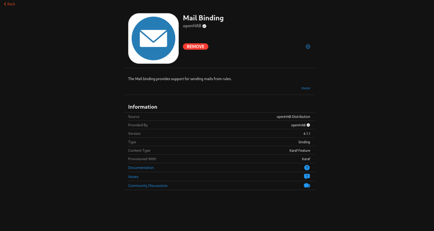

When you look at your installed bindings in MainUI, you will see a little gear icon.
Press it and you will see the logger settings.
Sorry, but I don’t know where a gear is. I don’t see any for myself.

Right hand side of the REMOVE button you see the gear symbol.
( this is not the latest version of OH but I assume it is still there )
